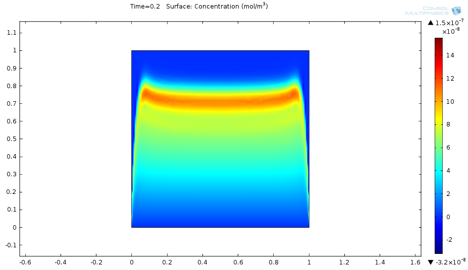

I made a minor change to your solver set-up and was able to get non-zero concentrations. See attached screenshot.
First, solve for the laminar flow study then when you solve for the species transport, click the "Values of variables NOT solved for" check box and use the final time step from the laminar flow study solution. Make sure to uncheck the "Laminar Flow" physics under the section "Physics and Variables Selection" for the transport of species study. You do NOT need to re-solved for the laminar flow because of the sequentially coupled (one-way) nature of the multi-physics problem.

Oops...just realized that the magnitudes are on the order of 1e-7. So, still no reaction to the cC concentration. Hmmm... I'll look a little bit more.
But, still it was worth pointing out that you don't need to re-solve for laminar flow.

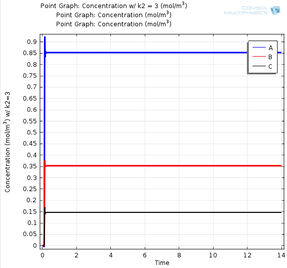

Okay. I believe I figured it out. If you increase your k2 reaction rate variable to a value of 3 you can see a good amount of reaction. I believe you had it set to many orders of magnitude less than this. I believe the reaction is happening in the other case, only it is so slow that you don't see it happening in the few seconds it takes for the fluid to pass through the domain.
