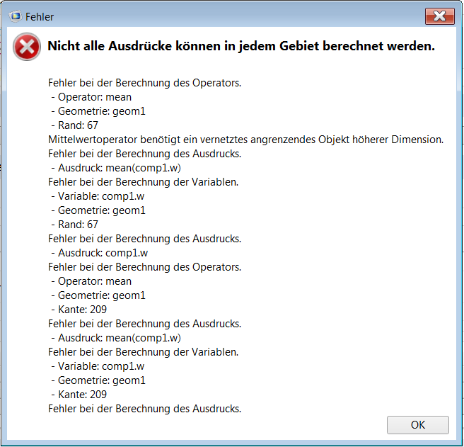

  • at z+w(x or arc length), Error caused by w (see picture attached)

Sure, from that results it would be possible to calculate the resulting real contour, howsoever.
But why do I always get pristine values for z, for all data sets? How can I obtain deformed position values?
Thanks, Sven
