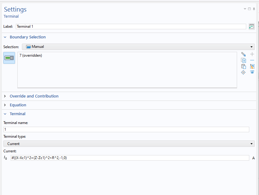

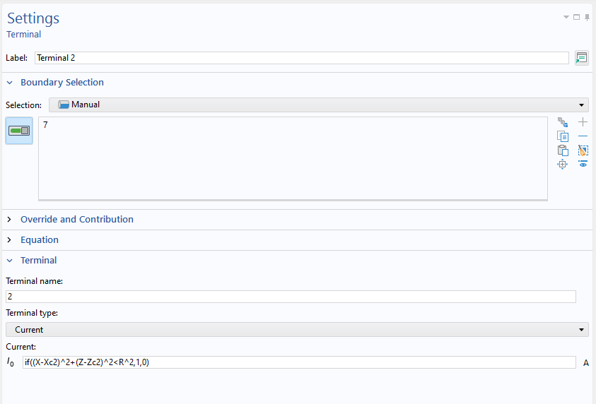

I was able to create partition and get my model to work but I am interested in learning this approach.
I am using the electric currents module and want to apply terminal and ground conditions to two circular partitions on a face. I replaced the ground another terminal to act as a sink (since the ground condition has no option to provide the equations).
I am giving a conditional statement like the one you mentioned but it is actually selecting the entire surface instead of a circular region.
Appreciate any help debugging this.
>Note that you do not necessarily need separate partitions to apply boundary conditions to, for example, a circle. You can write expressions like > >*if((X-Xc7)^2+(Y-Yc7)^2 I was able to create partition and get my model to work but I am interested in learning this approach. I am using the electric currents module and want to apply terminal and ground conditions to two circular partitions on a face. I replaced the ground another terminal to act as a sink (since the ground condition has no option to provide the equations). I am giving a conditional statement like the one you mentioned but it is actually selecting the entire surface instead of a circular region. Appreciate any help debugging this.
Posted: 7 months ago 2025/09/18 9:16 GMT-4
For more detailed help, I suggest that you contact support.
However, I think that one problem here can be that terminals are overriding features. So you can only have one Terminal node active on a certain boundary. That is, if you want to have several conditional terminals, you need to pile up all expressions into one Terminal node.
Henrik Sönnerlind
COMSOL
For more detailed help, I suggest that you contact support. However, I think that one problem here can be that terminals are overriding features. So you can only have one Terminal node active on a certain boundary. That is, if you want to have several conditional terminals, you need to pile up all expressions into one Terminal node.
