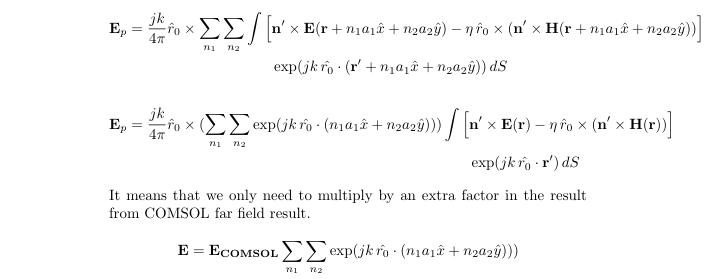

Hi guys. Now I am facing a problem of getting far field from an array. When calculating the near field, periodic condition is applied and only a single unit is calculated. But when I tried to apply far field node in the model, I think COMSOL only do stratton-chu equation on the single unit but not the whole array. Since I want to calculate the far field from the whole array, I think I need the integral on the whole surface of the whole array. Is there a solution for this problem now? Thanks!

I want to know the factor af3() could be. I think it should be a complex number. But from the document, it seems a real number. Is there a source of the array factor?

So if I want to apply this factor and calculate far field in Electromagnetic Waves, Transient. I think I need to multiply this factor in different frequency in far field node in Electromagnetic Waves, Transient. How can I achieve this?
