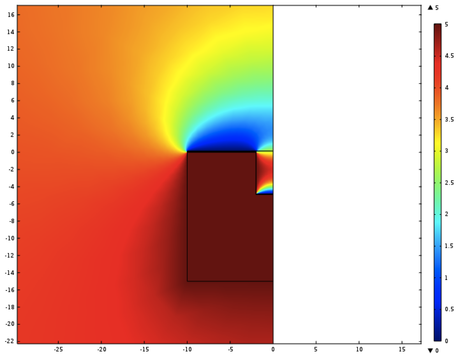

I am trying to simulate a structure which consists of different material layers. I would like to see Electric field and Electric Potential distributions of a certain potential applied to the boundaries of substrate (poly-Si). My multilayer structure includes two different metall layers. When I press compute, Comsol asks me to enter Relative Permittivity values for these metals, which is actually incorrect. I set them to 0.01 but also set all boundaries of metal layers to 0V potential. Is this approach is correct?

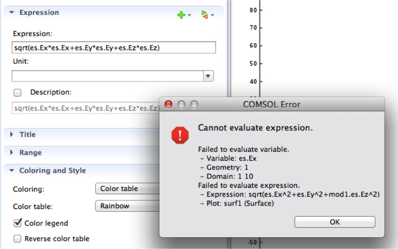

After computing Electric Potentials (image is attached), instead of V I type sqrt(es.Ex*es.Ex+es.Ey*es.Ey+es.Ez*es.Ez) in Expression field to get Electric Field distribution, however I am getting an error (image is attached), which says "Failed to evaluate variable ... Domain 1, 10". Material of Domain 1 and 10 is Air.

Update: Space geometry I am using is - 2D axisymmetric.
When I am drawing the same geometry but in 2D (without symmetry) I do not have an error described above and COMSOL plots Electric field without problems.
Any ideas?
Update: Space geometry I am using is - 2D axisymmetric. When I am drawing the same geometry but in 2D (without symmetry) I do not have an error described above and COMSOL plots Electric field without problems. Any ideas?
Posted: 1 decade ago 2013/05/11 11:26 GMT-4
In axial symmetry the spatial components are r, phi and z.
Cheers
Edgar
