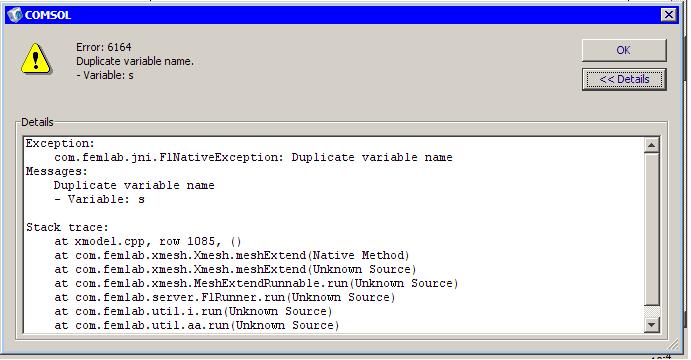

Dublicate variable name error
I have problem with <<Dublicate variable name>>.
I no more find a duplicate variable name in my constant or global expression.
Please help me resolve such strange problem.
Thanks

"s" is an internal name of COMSOL used for the edge length integration, so you must have used it somewhere else, if in none of your constants it could still be in an equations boudary condition, or just the initial coordinate variables
Hi "s" is an internal name of COMSOL used for the edge length integration, so you must have used it somewhere else, if in none of your constants it could still be in an equations boudary condition, or just the initial coordinate variables Good luck Ivar

Good
Thanks very much.
Even if I do not talk about variable "s" you know that it is that duplicate variable.
The problem was resolved when I change "s" to a big one "S".
Thanks very much.
Good Thanks very much. Even if I do not talk about variable "s" you know that it is that duplicate variable. The problem was resolved when I change "s" to a big one "S". Thanks very much.
