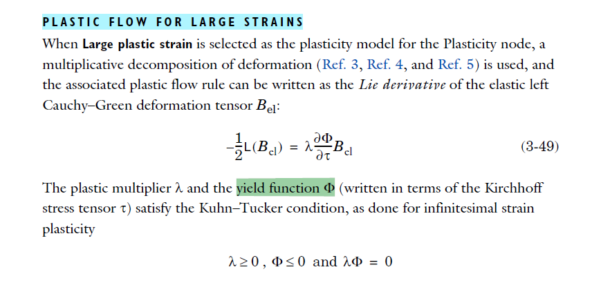

I am seeking clarification on the flow rule for finite plastic strain with multiplicative decomposition. In COMSOL 6.0 documentation, the flow rule is:

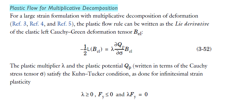

and in COMSOL 6.2 documentation, the flow rule is:
I am confused about which one COMSOL actually uses. Or are they equivalent? Any help will be useful, thank you. Please see the attached screenshots as well.

Hello Ratul,
There was a typo in the 6.0 documentation, which was corrected by version 6.2.
Jeff Hiller
Hello Ratul, There was a typo in the 6.0 documentation, which was corrected by version 6.2. Best regards, Jeff

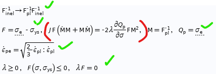

Thank you for your message. I however did some hand calculations and I think the 6.0 documentation was correct (in multiplicative plasticity, the flow rule is written in terms of Kirchhoff stress). I can derive the equation written in COMSOL's equations page from that, please see the bracketed term in the attached screenshot image(4). If I use the equation from 6.2, I do not obtain the Jacobian J, in the beginning of the equation. Could you please elaborate or point me towards the correct reference it was taken from?
Thank you, Ratul
