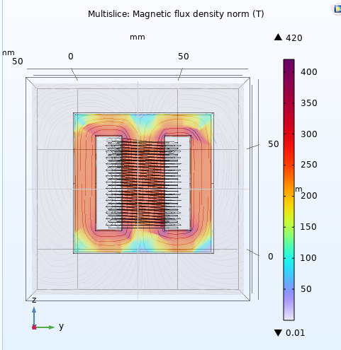

I am simulating a transformer with primary and secondary coils wound around the core limb. During the simulation, I encountered the following issues:
1. Issue with B-H Curve and Flux Density • I have assigned the B-H curve as the material property for the core. • After running a stationary study, the maximum flux density (Bmax) is showing approximately 400 T. • This value is physically unrealistic, since ferrite materials typically saturate around 0.3–0.5 T.
Question: Why is the simulation showing 400 T? Where could I be making a mistake in the setup?

First of all you must add another Ampere's law with the BH constitutive relation for the core domain. There may be more issues.

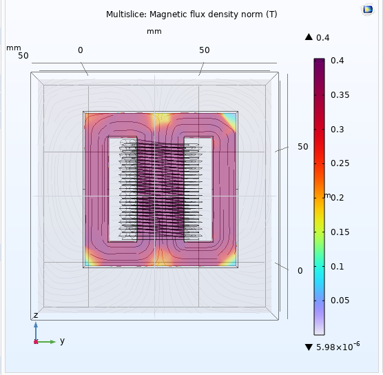

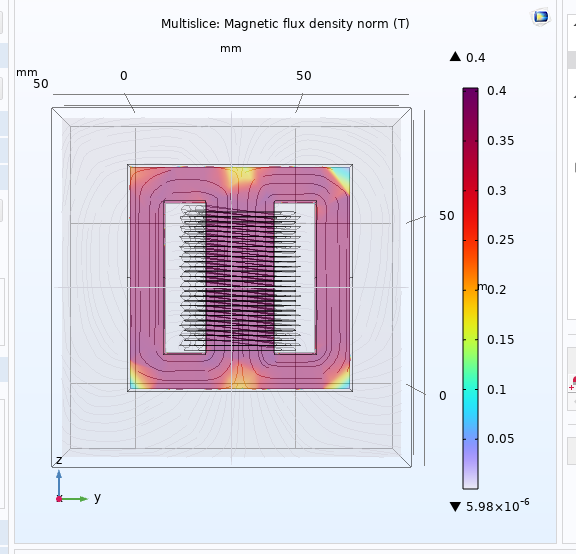

  1. Open Circuit and Short Circuit Giving Same Results
  • When I excite one coil (either with voltage or current), and apply open-circuit or short-circuit conditions to the other coil, The simulation results remain the same in both cases. This behavior is unexpected because:
  1. In open-circuit condition, only magnetizing current should flow.
  2. In short-circuit condition, high current limited by leakage inductance should flow.
*Question: Why are both cases producing identical results? *
**Below is the attached modified COMSOL file with the two pictures as with V=0 and I=0 in coil 2 **
Thanks @Edgar J. Kaiser for your valueable suggestion. Now can you address the second doubt. 2. Open Circuit and Short Circuit Giving Same Results * When I excite one coil (either with voltage or current), and apply open-circuit or short-circuit conditions to the other coil, The simulation results remain the same in both cases. This behavior is unexpected because: 1. In open-circuit condition, only magnetizing current should flow. 2. In short-circuit condition, high current limited by leakage inductance should flow. *Question: Why are both cases producing identical results? * **Below is the attached modified COMSOL file with the two pictures as with V=0 and I=0 in coil 2 **
Posted: 8 months ago 2026/02/25 8:05 GMT-5
A transformer isn't working in stationary conditions. So it doesn't matter if the secondary coil is open or shorted, because nothing is happening there. You must apply a time dependent current e.g. a sine function to the primary coil and use a respective time dependent study to see any induction into the secondary coil. I think there are transformer examples in the application library and also contributions in the COMSOL blog. I recommend to check those. You should also make yourself familiar with the theory of transformers and inductive devices.
