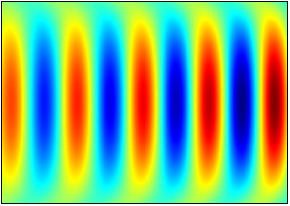

Dear all. I am trying to simulate a acoustics wave propagating through the air. The idea result should look like the attached picture. The version that I have is 3.5a. I am not sure if my PML setting is correct but it looks like there is nowhere I can set the radiation wave source. Anyone knows the trick? Should I couple with another model?
Here is my model. www.dropbox.com/s/xzrjlpp2s6bon58/PML_whole.mph
Any suggestions will be greatly appreciated!
