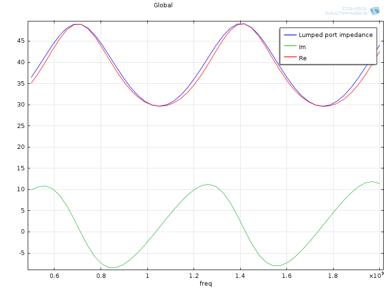

Thank you for reply, I used a similar way to the one you've proposed: doing a parameter study I looked for two consecutive points where the first port impedance becomes real; in one of these points the line length is lambda/4 + n*lambda/2 and the port impedance is equal to the load one, ZL (that is the other port impedance, 50 Ohm in my case), in the adjacent point instead the line length is n*lambda/2 and the port impedance is Z0^2/ZL (with Z0 line impedance) so you can easy find the value of Z0.
This work well, ok, but I want to understand how to use some fatures of COMSOL like a PML or a similar way to impose an adapted surface... how can I do it?
