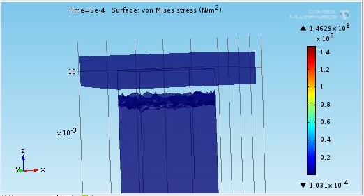

Posted: 1 decade ago 2013/06/17 21:46 GMT-4
My results look like attached file.
Even if I decrease velocity, contact part is torn off.
Any one has a idea?
My results look like attached file. Even if I decrease velocity, contact part is torn off. Any one has a idea?
