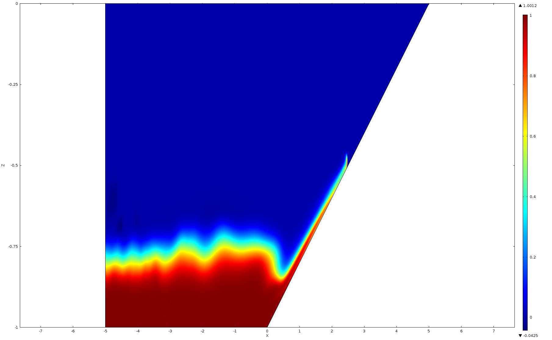

change the height of the legend bar
I wanna plot my result. The problem I face is that the domain is small,but the legend bar in the plot in not suitable.any idea how to make it small and fit to colorful height?
(Please open the pdf file)
Thanks,
Hooman

Mahdieh,
Thanks for the reply.
I want Comsol automatically change the height of the legend bar in according to the colorful area that for my case means be in (-1 to 0).
I tried to do use that zoom box but still I have problem.
Would you please give me more info?
Thanks,
Hooman

Mahdieh,
I had tried that before. it did not work. we need to keep the aspect ratio box in selected mood as the difference in x and z direction is not the same.!
Thanks,
Hooman

Mahdieh,
Please open the attachment..you will see what I mean.
