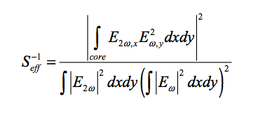

I am simulating nonlinear interactions in waveguides and would like to calculate the overlap integrals associated with those interactions. For example, I have found the modes and effective indices for a given structure at two different wavelengths and want to calculate the overlap integral as in the attached .png file.
When I set up the surface integral in comsol you are only allowed to choose data from one solution as inputs to the integral expression. Is there a way to write an integral expression that can use the data from more than one study?
