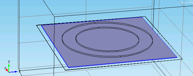

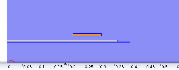

I have got stuck in to very simple problem, I have a built a 2D axis symmetric circular plate to model my inductor and in addition I want to add a metal square late. I have to use to 2D axis symmetric to get a circular coil but when I try to use rectangle in axis symmetric it becomes circle. Can't I make a normal 2D in 2D axis symmetric or vice versa
I have attached the 3D model of what I want

a square is not axially symmetric. Just as simple as that! It is not possible to mix 2Daxial and 2Dplanar symmetry. If you need that you have to use 3D.

Thanks Edgar for your answer. I have convergence issues with my 3D model and sometimes my RAM is not enough, I have 16 GB of RAM. Apart from 3D I cann't work around this issue?

in 3D you could try to model only a quadrant of the square and use symmetry BCs to save memory. If you don't need to resolve the inside of the metal (skin effect) you can use impedance BC at the metal surfaces to avoid messhing the inside of the metal parts.
In 2Daxial you can only try to replace the square by a disc.
