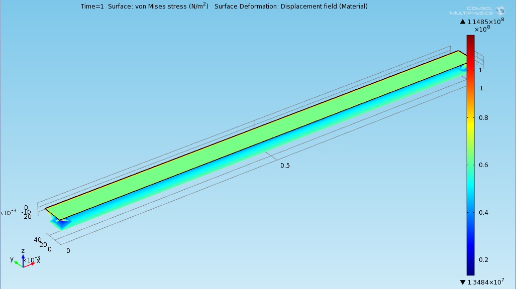

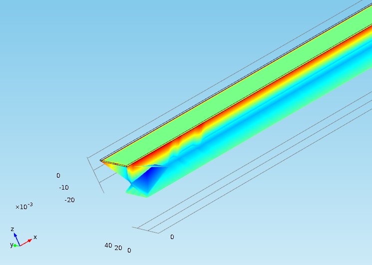

I am using the structural mechanical module to simulate the deformation of a ultra thin plate under the temperature change. the plate size is: length 100mm, width 5mm, height 0.1mm, the material properties are: E = 3.0e9, poisson ratio is 0.3, desity is 1000 kg/m^3 , coefficient of thermal expansion is 1.2e-4. I am using linear elastic material model and adding the thermal expansion under this model. the temperature is the only load which changes from 340 to 290 K. The Boundary conditions: the bottom plane is fixed, while all other boundaries are free. the final simulation result shows the upper portion is under the bottom plane, which is weird! It should above the bottom plane. please refer to the attached pictures.
I tested, this weird problem is possibly due to the fact that the ratio of length to height is too large. I change the height to 1mm, the length to 40mm, and the simulation results shows the deformation of the upper portion is above the bottom plane, which is reasonable.
Can anybody give an explanations and any help for simulating the ultra thin plate deformation? Thanks very much!

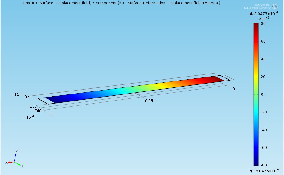

also, I tried to remove the bottom plane constraint, let the plate to free expand/contract. the simulation result is reasonalbe, please refer to the attached picture.
The problem is why the deformaiton is not reasonable when the bottom plane is fixed?

Have you made sure that this is not just a plotting scale issue? Is the the scale in the deformation plot '1'? What are the max/min values of the deformation in the Z direction 'w'?
Henrik
Hi, Have you made sure that this is not just a plotting scale issue? Is the the scale in the deformation plot '1'? What are the max/min values of the deformation in the Z direction 'w'? Regards, Henrik
Posted: 1 decade ago 2013/07/09 14:41 GMT-4
Thanks, Henrik,
I check the results, and it is the problem of plotting scale. the scale factor is over 900. when I set the scale factor to 1 or 10, the result seems reasonable. I wonder why comsol sets a defaut scale factor to the deformation result as it may be misleading. Thanks again.
