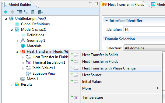

                                                    Dinesh,
What version are you running?
New in Version 4.3b you can add "Heat Transfer with Phase Change" as a domain physics condition to Heat Transfer analyses.
See attached screenshot from v4.3b.
Josh Thomas
AltaSim Technologies
                            Dinesh,
Josh Thomas
                                                Posted:
                                1 decade ago
                                2013/07/09 3:08 GMT-4
Dinesh,
Josh Thomas

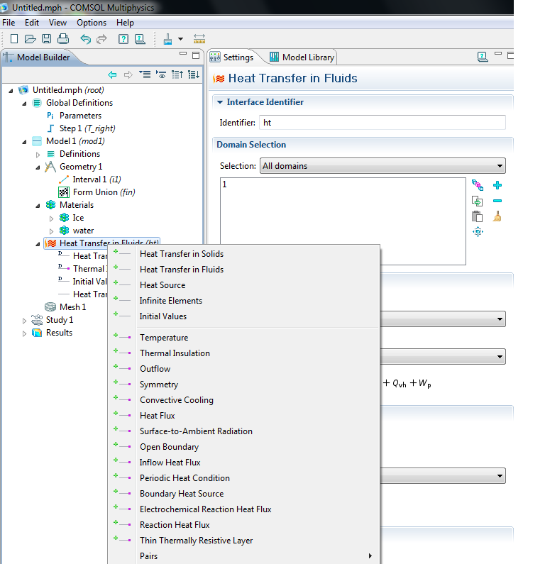

Sir
i am running 4.2a and 4.3 but both of these version dont have that option as i showed in the screenshot. Is it bcoz of version only. How can i add (phase change) in my version

                                                    Hello Dinesh
"Heat Transfer with Phase Change" is a feature that is unique to the Heat Transfer Module (see
www.comsol.com/products/specifications/heat-transfer/), so your screenshot suggests that you do not currently have that Module. You can check which Modules your license carries by going to the Options > Licenses menu.
