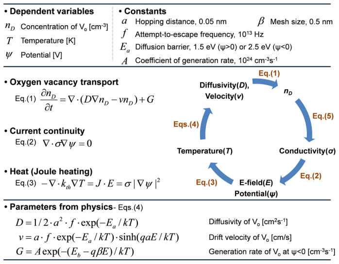

I am trying to solve two modules(drift diffusion and Joule heating) simultaneously. The model is of two electrodes with an insulator above them. In my simulation electrical and thermal conductivity is function of temperature. I am trying to solve this but still I can't couple them together.
Any advice on how to proceed would be greatly appreciated.
Sanjoy
I am trying to solve two modules(drift diffusion and Joule heating) simultaneously. The model is of two electrodes with an insulator above them. In my simulation electrical and thermal conductivity is function of temperature. I am trying to solve this but still I can't couple them together. Any advice on how to proceed would be greatly appreciated. Regards, Sanjoy

Hi Sanjoy,
I don't know what you mean with "drift diffusion", but in principle the coupling of two physics is carried out establishing which variable(-s) are common in the two (or more) physics. The first example that comes to my mind is Joule Heating coupled with Structural Mechanics: an electrical current generates heat due to resistance, thus a temperature field. In your structure (where the current is passing) you can have stresses due to thermal deformations, again caused by a temperature field. Therefore, in the setting of the physics, you establish this common point. How? in "Thermal expansion" of Solid Mechanics you specify, in the field "Model Inputs" the source of you temperature: instead of "User Defined", you should use temperature from the Joule Heating physics...Of course, you can have the inverse effect as well, for example the deformation of your structure will change the electrical resistance, and therefore the Joule Heating (like a circular dependence).
I know, sometimes it's not easy to find the common variables among the physics, but Comsol can help you showing the equation that the physics will use...
Sorry to give you a tip different than your model...if you have still problems, it's better that you upload your model here!

Hi Fabio,
I have same problem. I am trying to solve Drift diffusion(time dependent ) and Joule heating(time independent ) equations simultaneously. One important thing in my simulation is that electrical conductivity and thermal conductivity are function of Temperature(T) and concentration (cA). I have solved the drift diffusion equation first with a constant temperature(T0) and then coupled with joule heating equation by changing T0 to T.
The coupling was done by copying the solution and then changing " initial values of variables Solved for for" in the dependent variables option of the solver 1. After solving thing I don't get any electric field or potential in solution.
Could you please advise me ? I have attached the file herewith.
