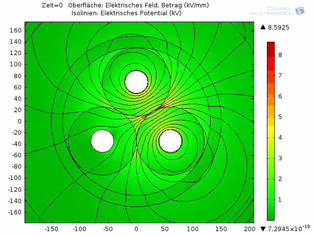

I try to reproduce the 3-phase cable simulation as shown in
www.youtube.com/watch?v=ZCLcbSQB1-Q
I used the electric currents physics and time-dependent. How to specify the phase shift among the three rods? Using "Time-dependent" don't allow me to specify the frequency. I attached the mph files here also. Any suggestion? Thanks in advance.

Jinxiang,
you can apply a complex value to the current. This allows to introduce phase shift.

Hi!
This was an electric field simulation, so better use ES, if you have materials with different epsilon.
In transient case you can simply add your phase shift to each potential definition.
Ralf
