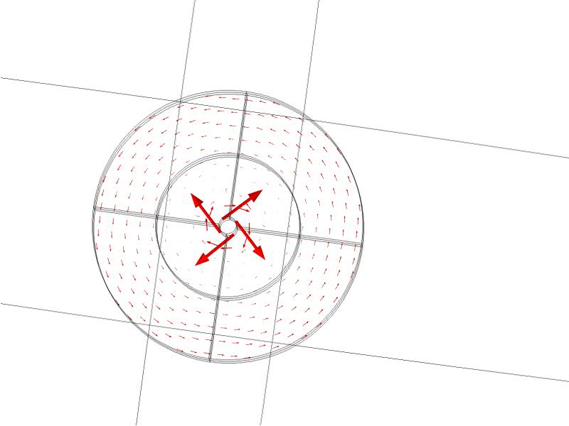

Anyway, I don't think Perfect Magnetic Conductor is the correct boundary condition. According to the documentation it sets the tangential component of the magnetic field to zero, which is not what I want. I tried applying it (in union mode) and you can see from the attached image that the current density in the coil is not right.
Yes, I think I do need to specify continuity, but how? The coil and the air don't actually have any touching boundaries, so I can't use Identity Pairs, can I? I need to somehow pair the coil boundaries with the air domain, but I can't find any way to do this...
