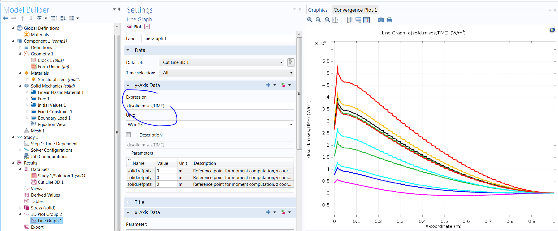

I tried to evaluate the largest value in solid mechanics, and the variable of interest is solid.mises. I used the same way as indicated in your model, but neither 'solid.misest' nor 'd(solid.mises)/dt' works. Do you have any suggestions? Mine is the 2D case.
Thanks a lot.

none of you two variable names, formulas do work in COMSOL, the dependent variables (in solid u,v,w) not solid.mises has a derived value defined. You could try the derivative operator d(solid.mises,t) but check in the doc why you should rather use "TIME" the mesh time, instead of "t" solver time.
Hi none of you two variable names, formulas do work in COMSOL, the dependent variables (in solid u,v,w) not solid.mises has a derived value defined. You could try the derivative operator d(solid.mises,t) but check in the doc why you should rather use "TIME" the mesh time, instead of "t" solver time. -- Good luck Ivar

u3-nojac(if(solid.mises>u3,solid.mises,u3)) where u3 is the dependent variable in ODE. I also set the damping coefficient to 0 as indicated in the blog. But what I got was not the maximum value of solid.mises during the time-dependent study.
When I randomly chose a point to evaluate solid.mises, it showed a realistic curve (shown in attached figure). However, when I evaluated u3 for the same point, it showed a monotone increasing trend (shown in the other figure attached), which is not correct. Do you know why did this happen?
Thanks a lot for the help.
Albert

Thanks for the suggestion. Indeed, I need to use "TIME" instead of "t".
Albert
