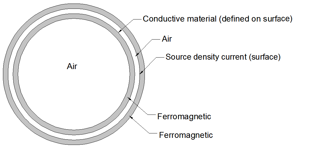

Posted: 1 decade ago 2013/09/12 17:35 JST
Hi Joao,
If I understand you correctly, you have:
A: a circle (area=0) with surface current density in A/m
B: a ring (area>0) with volume current density in A/m^2
If you integrate Jz in B along the thickness, that would be
give a surface current density in A/m. Is that what you are looking
for?
You would use a general projection to perform such an integration.
Regards
jens
Hi Joao, If I understand you correctly, you have: A: a circle (area=0) with surface current density in A/m B: a ring (area>0) with volume current density in A/m^2 If you integrate Jz in B along the thickness, that would be give a surface current density in A/m. Is that what you are looking for? You would use a general projection to perform such an integration. Regards jens

Hello Jens,
The figure in annex better explains what I was saying. (Check attach file)
I realized that I can define materials as surfaces (without area). Now I ask if I can induce a current on that surface (on conductive material in figure). If I can, than how can I plot the induced current density in [A/m] to compare with the source density current?
The only plot I can do now is showing me the induced current as [A/m^2], but the conductive material is one surface (without area). How can I convert to [A/m]?
I hope now is easy to understand and thanks for your help.
The best regards,
João
