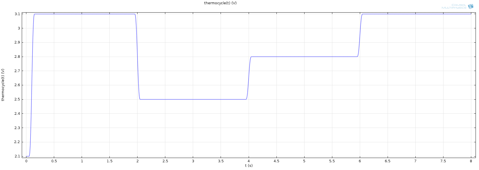

I am trying to build an analytical function that combines 4 steps to define my voltage cycling. However I can't figure out how to normalize the function. The steps go from 0 - 1, 1 - 0.4 , 0.4 - 0.7, and then 0.7 - 1.0, and when I add them it normalizes 2.1 - 3.1. How can I normalize this back to 0 - 1 on the y-axis?

Thanks Jens, I am trying to build an analytical function that combines 4 steps to define my voltage cycling. However I can't figure out how to normalize the function. The steps go from 0 - 1, 1 - 0.4 , 0.4 - 0.7, and then 0.7 - 1.0, and when I add them it normalizes 2.1 - 3.1. How can I normalize this back to 0 - 1 on the y-axis? Also, I noticed that you can add a periodic extension to an analytical function. Does this mean that I can make the function repeat itself because ultimately I want this cycle to repeat itself several times. The help in COMSOL doesn't really help and the parameters don't really make sense. Does anyone have any insight on this feature? Thanks,

I solved the normalization issue. But I am still curious about the periodic function.
