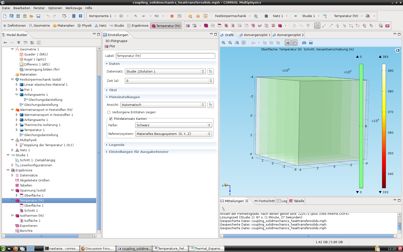

Hello everybody,
i have the same problem as above described. I want to model a coupling between strain and temperature distribution in a geothermal heat transfer where the fluid is injected through a sphere. My results are a bit confusing. I get a temperature distribution as implemented, but I get no strain distribution.
Attached you can find my model. Have I forgotten something? I can't understand the previous suggested solution.
In general I want to model thermoelastic processes. Is this the exact concept or thought at all?
Thank you and Cheers
Nastasja
Hello everybody, i have the same problem as above described. I want to model a coupling between strain and temperature distribution in a geothermal heat transfer where the fluid is injected through a sphere. My results are a bit confusing. I get a temperature distribution as implemented, but I get no strain distribution. Attached you can find my model. Have I forgotten something? I can't understand the previous suggested solution. In general I want to model thermoelastic processes. Is this the exact concept or thought at all? Thank you and Cheers Nastasja

Hello Nastasja,
The screenshot you sent shows the GUI in German, which is fine but you may get more feedback on your work from other users of the Discussion Forum if you posted your mph file: this way other users would be able to switch the model to whatever language they prefer.
Hello Nastasja, The screenshot you sent shows the GUI in German, which is fine but you may get more feedback on your work from other users of the Discussion Forum if you posted your mph file: this way other users would be able to switch the model to whatever language they prefer. Best, Jeff

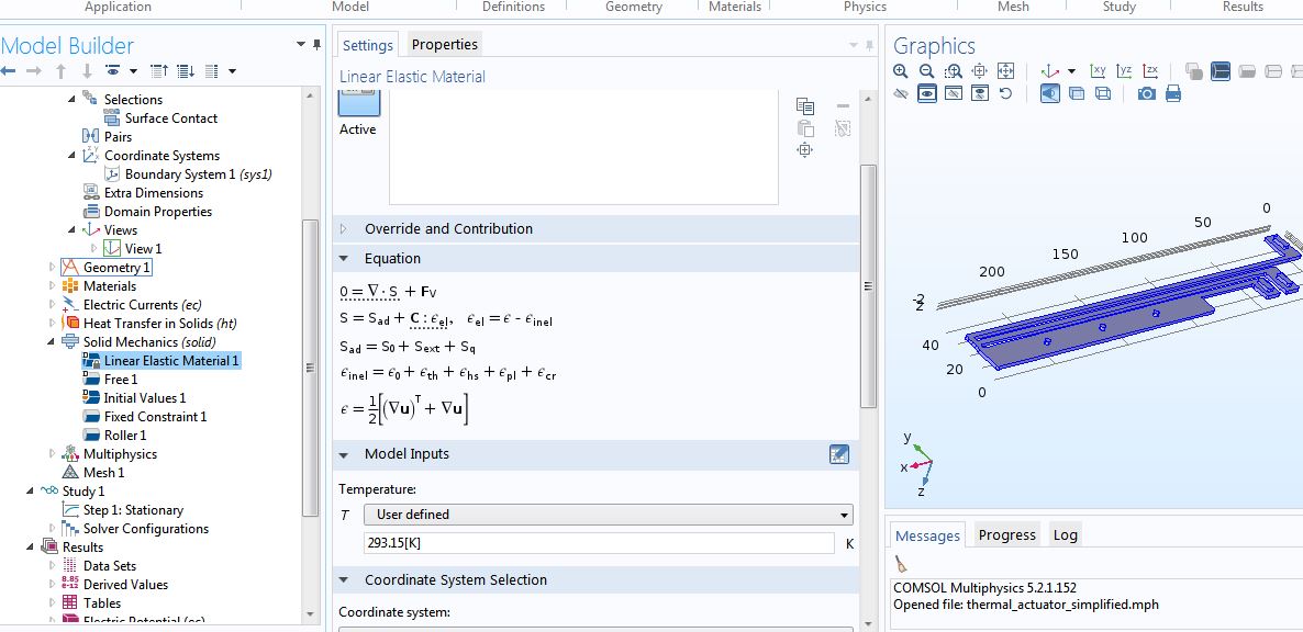

Hi Walter,
I do not see any modified equation in "linear elastic material" section. it is just stationary equations. Am I missing something? By the way, I see "linear elastic material" kind of locked. what does it mean?

Hi Adnan,
You have to make Equation View visible.
A screenshot of how to do that can for example be found (just below the second animation) in
www.comsol.com/blogs/how-to-make-boundary-conditions-conditional-in-your-simulation/
The 'padlock' symbol which you see indicates that the equations in that node have been edited manually.
