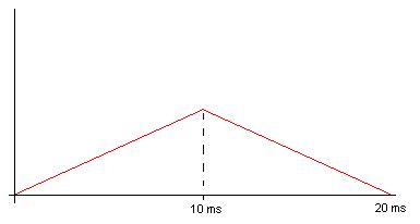

I'm trying to build a periodical wave. I want it to be linear, with its first semiperiod as an ascendent linear function, and the second semiperiod as a descendent linear function. Just like in the attached image.

I've been working on creating this wave, and i ve decided to define it this way:
(t*H0)*(t<0.01)+((0.02-t)*H0)*(t>0.01)
I've realised that what i was trying to do at the beginning was a bit complex. The result is on the attached image. I only need one period of this wave. If i need the wave to be periodic in time, i'll have problems, because this description is not ok, the resultant wave is permanently decreasing from t=0.01. I'll investigate more.
