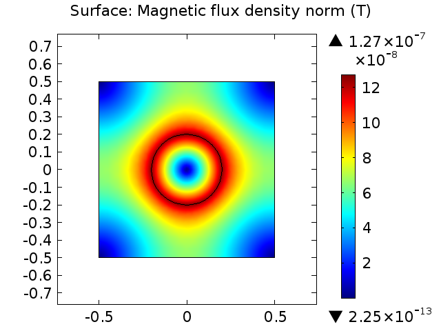

Now would you mind giving me some hints as to how I can modify this model to be able to view magnitude of the out-of-plane magnetic field generated by this simple wire? I have tried simple adding "magnetic field" physics to the study and it generates the surface plot but the value appears to be zero everywhere. I know I'm missing something obvious here, like the air conductivity thing, but I'm not sure what.

Matthew,
Not sure if I understand what you are trying to accomplish, but in 2D geometry wire must go in the out-of-plane direction, as shown in the attached image. Assumption is that current loop is closing at the infinity.
Sergei
