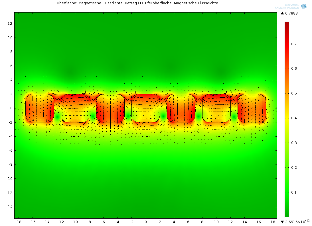

hello, i want to make a permanent magnet, and see the magnetic flux density norm using arrow surface. i found a picture of a magnet, see attached photo, but i need to know how i can make this, because i need similar magnets for another project. i've been trying different methods but so far it has been unsuccessful. please can someone help me.?

You can use my example for a Halbach array; this is in 2D.
So I don't know, what do you mean with "flux lines in and out of the paper"...
In 2D this is not possible.
Ralf

Hy Ralf, immense thanx for ur responce.
The figure is in accordance to my requirement but I cant open the comsol file because of later version.

Hello!
My version is 4.3b, as you marked above...
I use remanent flux density; rotating direction from piece to piece:
first piece: +1.2T in y direction, second piece: +1.2T in x direction, third piece: -1.2T in y direction and fourth piece: -1.2T in x direction and so on...
Other properties are sigma=1S/m and epsilon_r=1.
Ralf

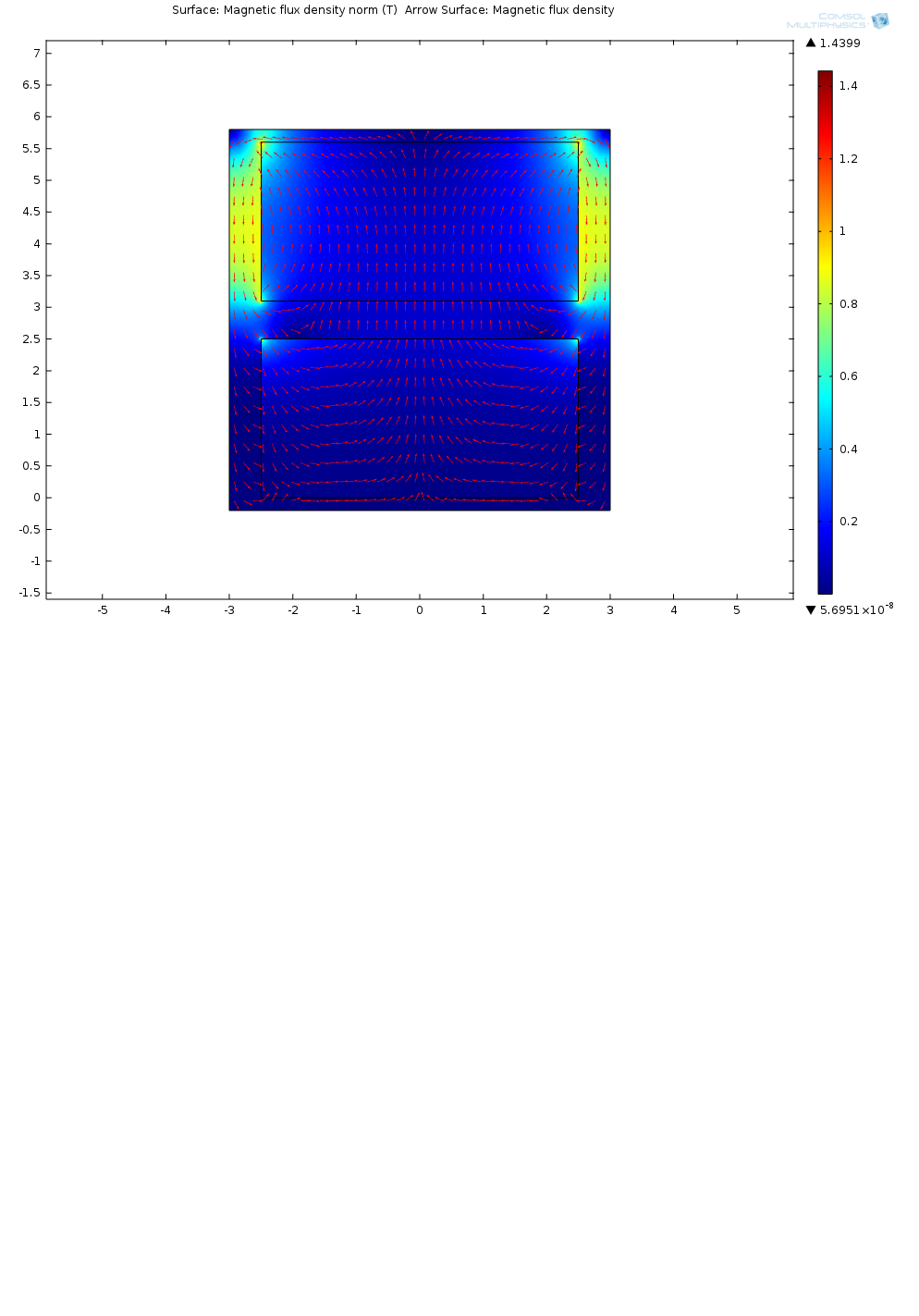

Posted: 1 decade ago 2013/10/30 13:00 JST
Thanx a lot Ralf...
I have attached the image below, I assigned remenant flux in accordance to ur instructions.
And let me know last few queries, these might be basic but new for me, so plz let me know that is there something like geometry dependency like I should Flux for circular or curved shape geometries and for straight or rectangular parts, I should use AIR medium and what should be the value of Tesla?
And is cube or cylinder formation is necessary around geometry/magnets to check magnetic field with its medium as air?
And last thing plz that I want to know is that I have fixed the base of a beam and want to check the displacement at a Force with frequency of 50 Hz. Plz mention just brief steps.
Regards and thanx in advance.
Thanx a lot Ralf... I have attached the image below, I assigned remenant flux in accordance to ur instructions. And let me know last few queries, these might be basic but new for me, so plz let me know that is there something like geometry dependency like I should Flux for circular or curved shape geometries and for straight or rectangular parts, I should use AIR medium and what should be the value of Tesla? And is cube or cylinder formation is necessary around geometry/magnets to check magnetic field with its medium as air? And last thing plz that I want to know is that I have fixed the base of a beam and want to check the displacement at a Force with frequency of 50 Hz. Plz mention just brief steps. Regards and thanx in advance.

Hi!
I think the best would be to study comsol manual and some of the examples in the model gallery:
www.comsol.de/models/acdc-module
There you should find some more explanations for basics.
Ralf
