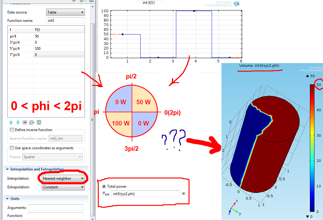

There is 3D model. Heat transfer module. I need to set Heat Source depended on "phi"-coordinate.
I defined a cylindrical coordinate system (sys2) with default settings, also defined an interpolation function for heat source (int3) - table f=f(t), where t [rad], f [W]. Then in Heat Transfer in Solids --> Coordinate System Selection --> Cylindrical System 2 (sys2), then I created Heat Source with Total power = int3(sys2.phi).
In result i have incorrect calculation of Heat Source (see attached picture).
What have I done wrong?

Helllo Mikail,
Does the angle inside Comsol lie in the interval [0,2*pi]? Or perhaps in [-pi,pi]? The latter would explain your result.
Have you tried making the piecewise function periodic?

Helllo Mikail,

Interesting idea about [-pi,pi]! I will try to use this angle. Thx :)
How can I make the piecewise function periodic?

The combobox for extrapoation has an item "periodic"

The interval for the azimuthal angle phi in Cylindrical System and Spherical System coordinate systems is [-pi, pi]. The interval for the angle of inclination theta in Spherical System coordinate systems is [0, pi].
