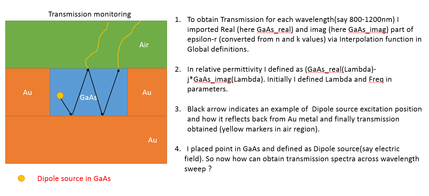

(I had attached the concept of my simulation as picture where you can understand my idea)
My Goal is to get PL spectra (may be Transmission ) vs wavelength. I had placed Point in GaAs and used that as Dipole source. My target is to achieve Transmission spectra coming out from GaAs vs wavelength (say 800-1200nm). I m really confused here how-to-do. For obtaining transmission spectra do I need to use port condition or what ?
Certainly, you could put a boundary probe on the top air boundary to record the transmitted field, but there are several questions to determine. It is far enough away from the GaAs/Au structure to form a uniform field appropriate for retrieval? How do you determine the baseline "incident" power from a point dipole inside a small structure (i.e. in the near field)?
I've set up a short example that is probably not very accurate, but at least demonstrates the challenges of trying to do what you have requested. I set up a boundary probe on both the air and the GaAs/Air interfaces, as well as a point domain probe placed near the dipole. The results of the normalized and averaged power transmittances are shown in the global 1D plots, and show the discrepancies between using the GaAs/air boundary and the point probe.

First of all thanks for your model and try. Its really helpful since I m just beginner in COMSOL. I had attached the geometry of my structure . Previously i used Scattering BC, but now changed to PML as per your ex.
For obtaining transmission(hereafter T or PL) spectra, i think we can adjust the height of transmission monitor to get the best from GaAs top surface.

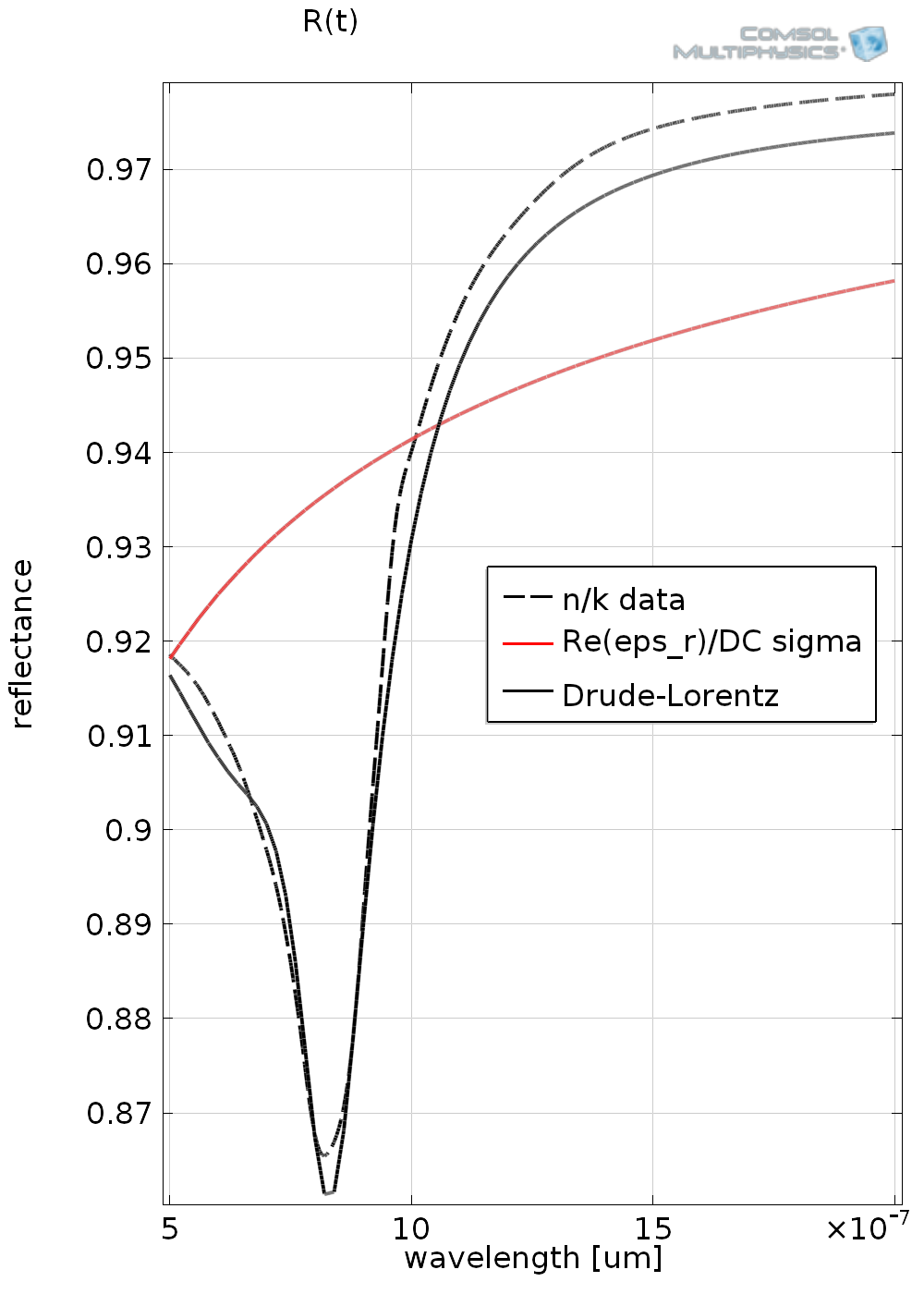

I'd like to address first that you have n/k data, but you keep reverting to permittivity. I would not suggest this. I have looked extensively into the different "Electric displacement field" models, and it will generally be best to use n/k data and solve for index if you have good n/k data on your materials. Look at the equations for "refractive index": eps_r = (n-ik)^2, and sigma = 0. The loss is accounted for in the k term, so it is permissive for sigma to be zero. But when solving for "relative permittivity", defining eps_r = (n-ik)^2 in your material properties and setting sigma = 0 is the SAME MODEL as the index model. It appears that the best use for the perimittivity model is when the eps_r term is expected to be a real component, and the sigma term is expected to be the DC conductivity, and the material loss is encompassed in this conductivity term. Now, either eps_r or sigma MAY be complex, such as utilizing an optical conductivity, but if both term are complex, it seems from the equations that the loss would be double counted--this was confirmed by a COMSOL tech.
From a test of several different displacement field models, I have found that for gold or aluminum in the optical regime, the only way to accurately match n/k data is to use the Drude-Lorentz model (out to five oscillators), defining eps_infinity as 1-(f0*omega_p^2)/((2*pi*freq)^2-i*(gamma_p*2*pi*freq)), with f0 the high frequency oscillator strength, and omega_p and gamma_p the plasma and damping frequencies, respectively. I've attached a graph of using three different models and measuring the well-known reflection of aluminum in the optical regime. The n/k and Drude-Lorentz models match well, but the relative permittivity model, using a real eps_r and a DC sigma, do not, because it does not account for the optical transitions. I will upload the model so you can play around with different methods, too.
