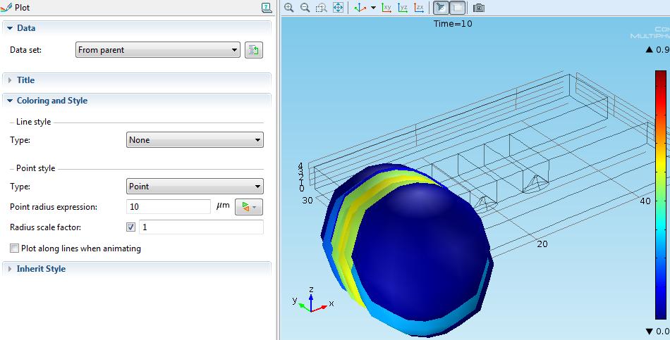

I have designed a microweir structure inside the microchannel to separate cells of different dimension. The structure acts such a way that it allows smaller cells to flow over it and blocks the bigger cells
I have designed a simple channel in 3d which is 5 x 10 x 4 micrometers (Width x depth x height) and have included microweirs into it. In the Particle tracing physics i have inputted the particle diameter dp as 10 micrometers. And the simulation result shows the Particle trajectories.
My question is how do my particle of bigger dimension flow in a smaller channel? Is there a way to use the exact dimension of my particle without scaling it down.
Please help me as am trying to solve it since a long time
Thanks,
Lalitha
Thanks,
Lalitha
