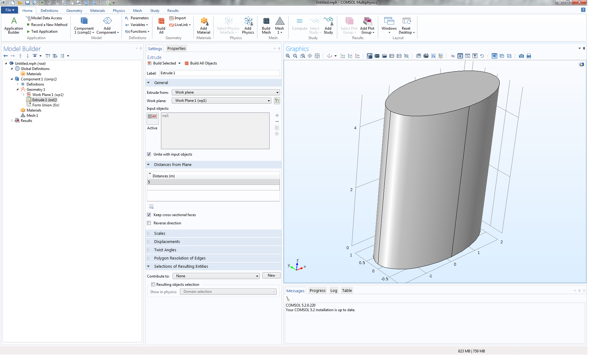

You can draw an ellipse in a workplane and extrude it.
You can draw an ellipse in a workplane and extrude it. Best regards, Jeff
Posted: 9 years ago 2016/06/09 10:15 JST
It works. Thanks a lot!
