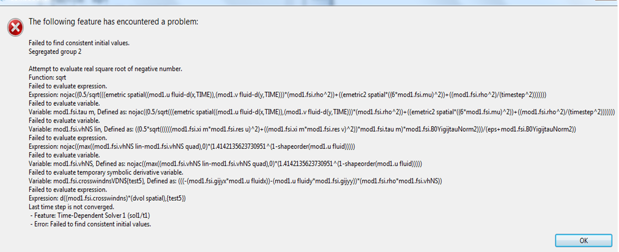

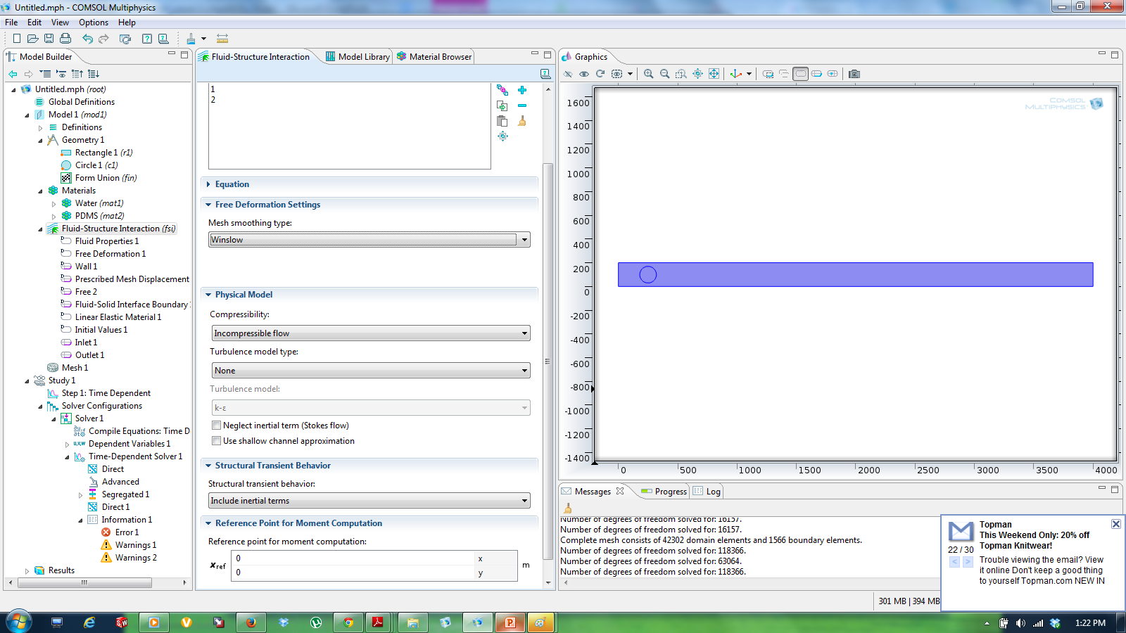

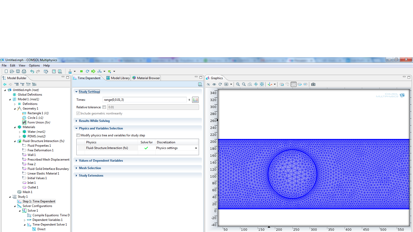

I am trying to simulate FSI for a moving sphere (diameter=140um) in a 2D duct (lenth=4000 micrometer and width=200um) (it is microfluidic channel). I have attached a picture of my model and a picture of the error I am facing. Here is my boundary condition detail:

my model: FSI: time dependent/ mesh smoothing type: winslow/ incompressible flow/
mesh:fine
Could you help me to fix this problem? Is the choice of my BC correct? How about my model and mesh setting?
