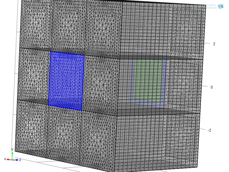

I have a problem with the mesh I am using, and I wonder if someone could help me out here. I'll try explaing it using the attached files, I apologize for the length of this post.
The file "Screenshot_20131122.png" shows the general structure of my "Mesh 2".
It also shows my geometry, which consists of an array of 3 x 3 blocks and - on the back of each block - electrodes with a size in x-y slightly smaller than the x-y areas of the blocks.
For the mesh, I want to define the following:
- A "free triangular mesh" for the front and back surfaces
- A "Swept" mesh for the blocks.
Also, for the central block (marked green in the Screenshot picture), I want a "Extremely fine" mesh both for surfaces as the block. For the neighbour blocks I want an "Extra fine" mesh.
Hence, both for "Free Triangular 1" as for "Swept 1", I have two Sizes: "Size 1" ("Extra fine") and "Size 2" ("Extremely fine").
There is also a general "Size" node just below "Mesh 2", which I have set to "Extremely Fine", though I am not sure what it serves for... Does this general size node overwrite some of the other sizes set in the sub-nodes? (It seems like that actually).
In "Free Triangular->Size 1", I select the front and back surfaces of all blocks except the center block. Hence, these are 24 surfaces in total, (8 in front and 16 in the back: both the back surfaces of the blocks and the front surfaces of the electrodes).
In "Free Triangular->Size 2", I select the surfaces for the center block. Hence, these are 3 surfaces: the front surface, the block back surface, and the electrode front surface (see CenterPixel_Surfaces.jpg).
In the Free Triangular general node, I select only the back surfaces of all the blocks (i.e. 18 surfaces in total).
For "Swept 1->Size 1", I select all neighbouring blocks (i.e. 8 in total).
For "Swept 1->Size 2", I select the center block (which has label number "8").
Fine. This all works. (I.e, I can build the mesh and then run the simulation on the mesh).
However, I have the feeling this is not completely correct.
For instance, to me it seems wrong to have only the back surfaces of the blocks in the general "Free Triangular" node selection. So, I tried putting all surfaces (front and back) into this selection.
(I.e., all surfaces from "Free Triangular-> Size 1" plus all surfaces from "Free Triangular-> Size 2".)
Then I get the error message (which appears under the Swept node:)
- "Source and destination faces must be specified"
So, I guess I had to specify the source and destination faces inside the general "Swept 1" node. (Which were empty up till now).
So, for "Swept 1 -> Source Faces", I put all the front surfaces (9 in total) and for "Swept 1 -> Destination Faces", I put all the back surfaces (18 in total). Now I get the following error:
- "Each destination face must uniquely correspond to one or more source faces."
When I do it the other way around: for "Swept 1 -> Source Faces", all the back surfaces (18) and for "Swept 1 -> Destination Faces", all the front surfaces (9 in total), I get the following error:
- "Failed to create swept mesh for domain."
-- "Mesh on source and destination face do not match."
My conclusion is that the number of source faces and destination faces should be equal. Is that right?
So I tried that: for "Swept 1 -> Source Faces", all the front surfaces (9) and for "Swept 1 -> Destination Faces", only the "electrodes" back surfaces (9).
- "Unsupported topology of domain." (with one corner block highlighted)
- "Unsupported topology of linking face." (with a back surface of the corner block highlighted)
I can understand this, since part of the "swept block" does not have a surface defined on the back end. But then, I don't see how to correctly define the mesh, unless I use the original set-up.
However, I have the feeling that I am doing something wrong there too, even though COMSOL does not complain.
I do apologize for this rather long (and maybe confusing) message, but I don't see how better to explain it.
Any help would be very much appreciated.
Sincerely,
Machiel
