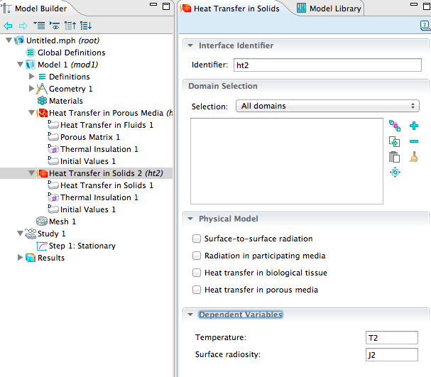

If you want to combine the heat transfer in both of them first of all you need to use the same variable T.
By default COMSOL usually set T as the temperature variable for the first physic and T2 for the second.
Let me know if it works.

Hi Marino,
I set T as dependent variable for both physics.
Please find attached my model.
The domain 3 is water, it's characterized by laminar flow and heat transfer, the domains 2 and 4 are the pipe (solid-steel) and now the domains 1 and 5 are a rock (solid granite). I would like to turn them (domains 1-5) in a porous media (soil).
I added the new physics: heat transfer in porous media, I set T as dependent variable. Now I think that my main problem is that I need to remove the boundary condition "thermal insulation" in the boundary 2 and 12 to be able to link the two physics. Do you know how I can do?
