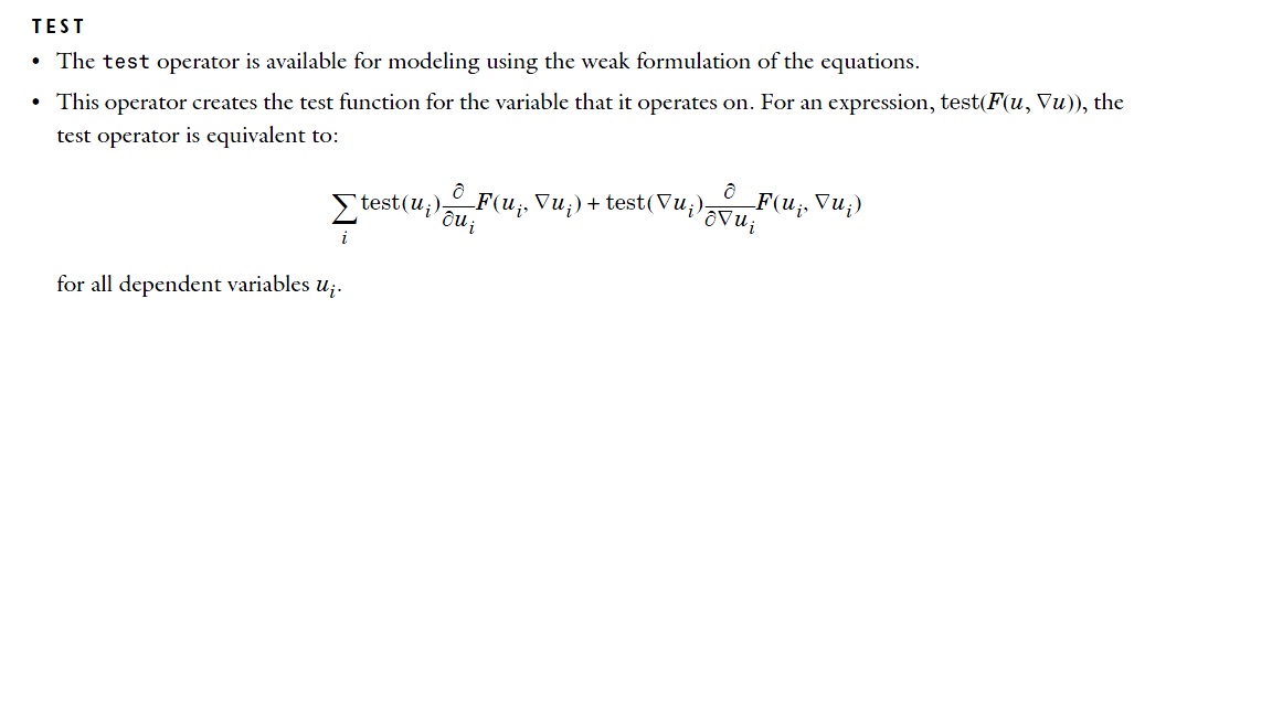

Posted: 10 years ago 2015/06/11 17:48 GMT-4
In the attached image is the answer for the test function. hope helps
