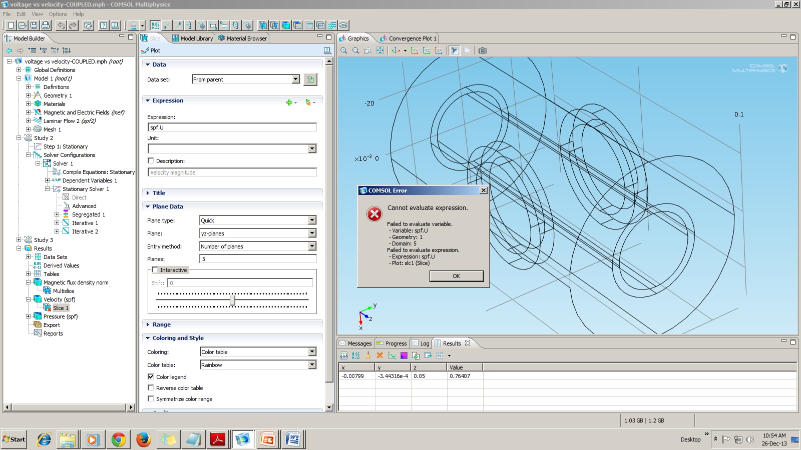

This is N.Kumar from IIT MADRAS, I was trying to get the 2d plot for the electromagnetic flow meter.in this regard i was facing the preoblem as,
failed to evaluate variable:
variable:spf.U
Geometry:1
domain:1
Failed to evaluatr expression:
expression:spf.U
plot slc(1) slice.

Hello Kumar,
Your laminar flow has identifier spf2, therefore you should plot spf2.U. This should fix the error.
Frank
