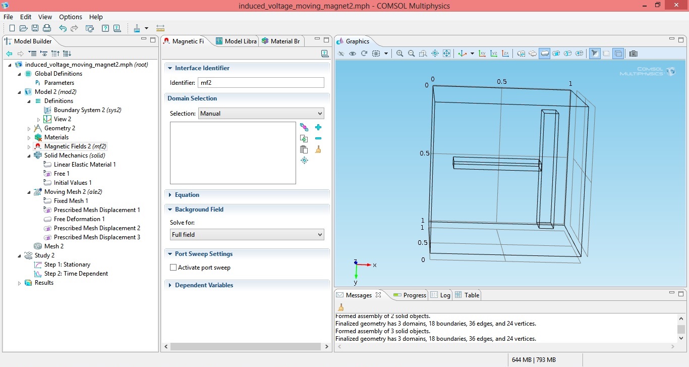

I am confused about that, Plz have an overview of the attached file, this can make my case clear:
Plz plz guide me that which "Physics+Study" should be carried out for the voltage induction from a rectangular beam of a magnet (parallel to x axis ) to a simple coil (parallel to y axis)? The beam is fixed at one end.
What I am trying is moving mesh, solid mechanics for fixing one side of beam and applying force for displacement and magnetic field physics (ampere's law & multi-turn linear coil with reference edge).
Which domains I should use in moving mesh (if it is required)? In output I want a SINUSOID.

Mahmood,
Looking at the screenshot of your mode, I assume that entire coil is fixed, beam is cantilever and can move due to Lorentz force. Based on these assumptions, several notes on your model:
1. All domains should be selected in Magnetic Fields (mf2) interface;
2. Only beam should be selected in Solid Mechanics (solid) interface;
3. Only air domain should be selected in Moving Mesh (ale2) interface. Young’s modulus and Poisson’s ratio for air are not needed. Comsol is asking these properties because you included air domain in Solid mechanics interface.
4. Beam movement is governed by Solid Mechanics interface, so it is not necessary to include beam in Moving Mesh interface. However, use Prescribed Mesh Displacement boundary condition in Moving Mesh interface to set displacement of the beam boundaries to (u,v,w).
5. Apply Maxwell’s stress tensor forces on all boundaries of the beam in Solid Mechanics interface. This is the coupling between Magnetic Fields and Solids Mechanics.
6. You coil looks very strange: where is closed loop for current flow?
7. You can get away with only one Time Dependent study step.

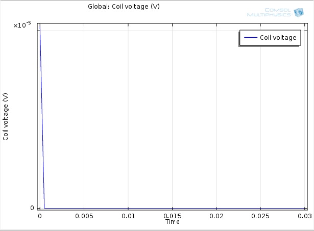

Just guide me about the Sinusoid output of VOLTAGE which a straight line in the last file send by you. Is voltage induced or I am getting it wrong? Whereas Vibrations are perfect and their sinusoid is there.
Please give me that last favour about Sinuoid of VOLTAGE output (which you shared by Maxwell's stress was perfect but it was by Stress). And my work will be done.

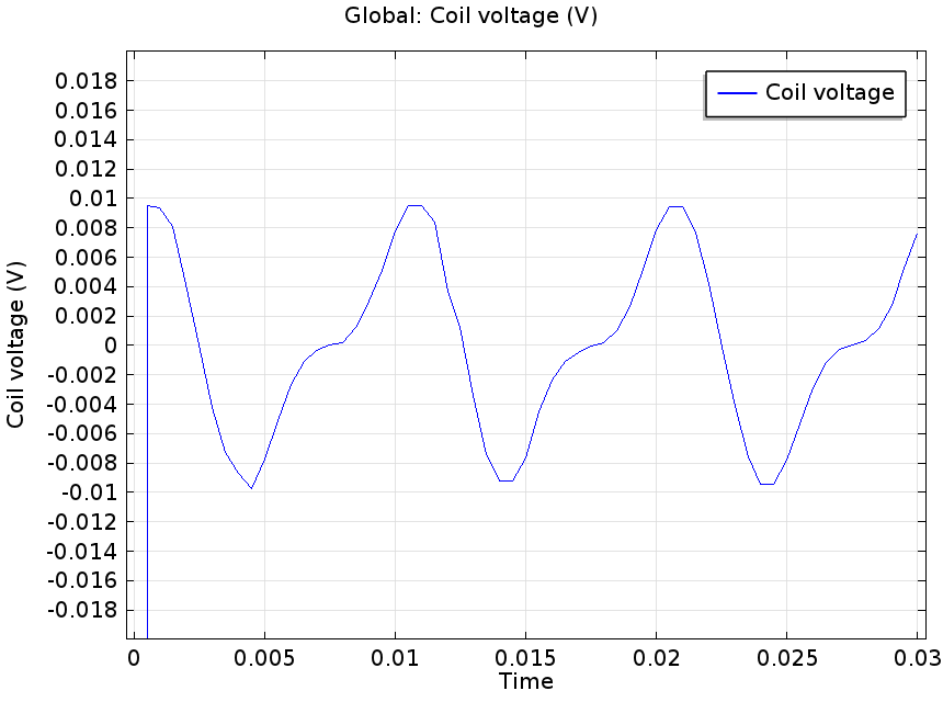

Posted: 1 decade ago 2014/01/14 0:18 JST
Mahmood,
Attached is model with induced sinusoidal voltage of the coil.
Sergei
Mahmood, Attached is model with induced sinusoidal voltage of the coil. Best regards, Sergei
