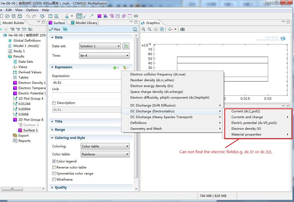

                                                    Dear Mr.Gritter,
      I found that using the FEM(Finite Element Method) is very hard to complete the DBD simulation(it is always not converged ). Then I change to the FVM(Finite Volume Method), it is easy to get converged, but I found the results do not contain the Electric Field! What's wrong with it? Is it said that if I want to caculate the Electric Field I must turn back to the FEM? Is there any other method solve this problem, e.g. adding the AC/DC model to the PLASMA model?
                            Dear Mr.Gritter,

                                                Posted:
                                1 decade ago
                                2015/01/21 9:39 GMT-5
                                                    Predefined variables for the electric field are included with the finite volume formulation, though they may not show up in the variable lists.  In 3D, the electric field components are dc.Ex, dc.Ey, and dc.Ez; in a 2D axisymmetric model, the electric field components are dc.Er and dc.Ez, and so on.  If you simply try to take the gradient of the electric potential (e.g. -Vx), you will get a value of zero due to the fact that the electric potential is constant within each element and discontinuous at element boundaries.
Luke Gritter
AltaSim Technologies

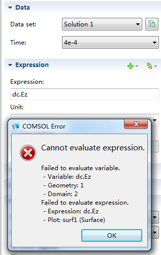

                                                Posted:
                                1 decade ago
                                2015/01/21 21:16 GMT-5
                                                    Dear Mr. Gritter,
      My model is a 2D DBD with planar electrodes.  I try to plot the Electric field again, But under the expression selections, I still can't find it. So I type dc.Ez in the expression, it come out a error: Can not evaluate expression.(see the Attach File)
     Hoping for your replying.

                                Luke Gritter
                                                                                                                                                    Certified Consultant
                                                Posted:
                                1 decade ago
                                2015/01/22 9:22 GMT-5
                                                    If you have a 2D model, there is no electric field in the z-direction.  The electric field components are dc.Ex and dc.Ey.
Luke Gritter

                                                Posted:
                                1 decade ago
                                2015/01/22 9:25 GMT-5
                                                    Oh, it is 2D axisymmetric model.

                                                Posted:
                                1 decade ago
                                2015/01/22 9:35 GMT-5
                                                    Which version of COMSOL are you using?  Is domain 2 a plasma or dielectric domain?
Luke Gritter
Luke Gritter
                                                Posted:
                                1 decade ago
                                2015/01/22 9:39 GMT-5
                                                    I use the 4.3a, and the domain 2(the middle one) is plasma.
                                Luke Gritter
                                                Posted:
                                1 decade ago
                                2015/01/22 10:07 GMT-5
                                                    The implementation is somewhat different in the older versions, and I'm not sure whether there is a way to postprocess the electric field in version 4.3a.  In versions 4.4 and 5.0, at least, the electric field can be visualized using the variables mentioned above.
Luke Gritter
