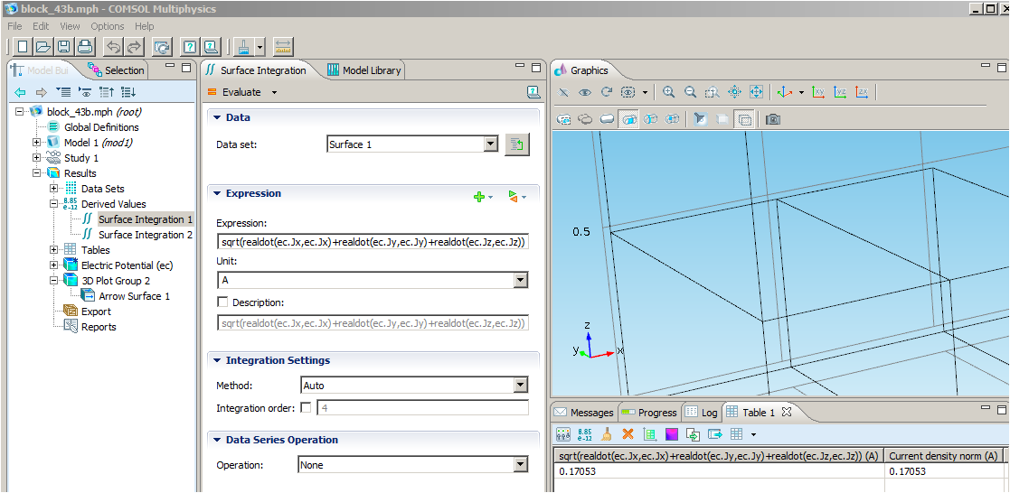

Something I can't understand. See the attached trivial model. In Surface Integration 1, if I select ec.nJ from the menu, I get an error message (same with trying to plot it or export it), but if I look up the definition of ec.nJ in Equation View of Current Conservation 1, and enter that expression, instead of ec.nJ, it works fine.
ec.nJ is defined as:
sqrt(realdot(ec.Jx,ec.Jx)+realdot(ec.Jy,ec.Jy)+realdot(ec.Jz,ec.Jz))

Evgeni,

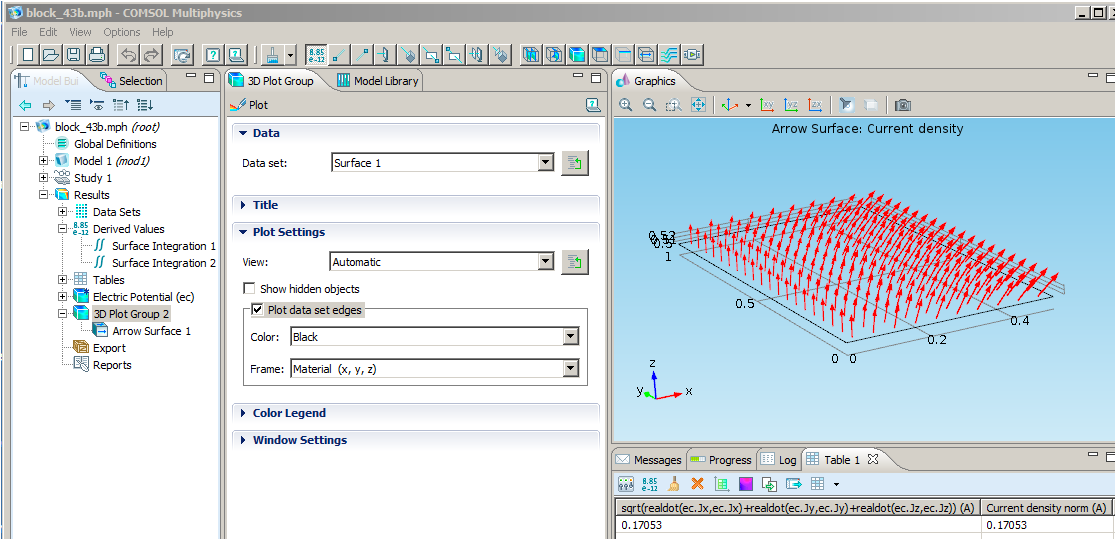

Not sure why you are getting the error message but attached is your model file with evaluated integral of the normal current density over internal surface.
Both methods of the surface integration of
sqrt(realdot(ec.Jx,ec.Jx)+realdot(ec.Jy,ec.Jy)+realdot(ec.Jz,ec.Jz)) and ec.normJ
work fine and give the same result.
Sergei

Actually, on nth thought, we shouldn't need to go through the hassle of defining a complementary physics interface or dealing with assembly pairs just to find the current through a boundary.
So I've tried integrating
realdot(sys1.e_n1, ec.Jx) + realdot(sys1.e_n2, ec.Jy) + realdot(sys1.e_n3, ec.Jz)
over an internal boundary, and it worked! (Checked against the method with the two Electric Currents interfaces that I've written about above.)
