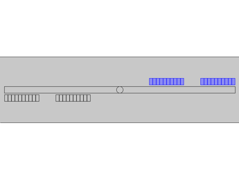

i still have some issues with coils ! i am trying to simulate a 10 turns spiral coil in 2D ( not Axisymmetric )
i built 10 separated rectangles to represents the coil turns. Now , five of them should have reversed current direction which i managed to do using the Single- Turn Coil options. However, i still didn't get how the " Coil group " check box functions ? and after checking the box i have this option of " Domain Group " ! . the Help information was really shallow and i couldn't get the deference !
So ; it will be really great if you can explain more about these features in COMSOL 4.4
Coil group ?
Domain Group ?
and is there any deference in such cases between 2D and 2D Axisymmetric ?
what i should use for my case ?
a picture is attached for more understanding
Best Regards ;

say for simplicity there a two rectangles representing this coil.
If you uncheck "coil group" the two rectangles will be treated as one
solid piece of conductor. In a way you can say the two wires are in parallel and
the voltage drop over the rectangles is equal.
If you check "coil group" then the wires are connected in series and the
total current over the rectangles are equal.
The "domain group" now lets you mix parallel and series connection, but
I have not yet used this myself.
