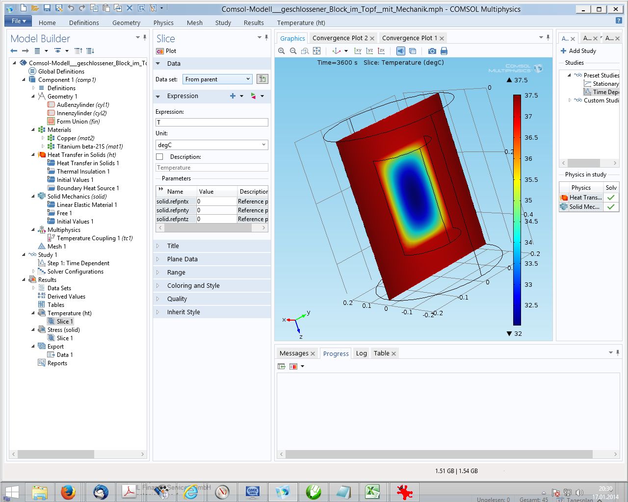

I get a reasonal temperature distribution from the calculation.

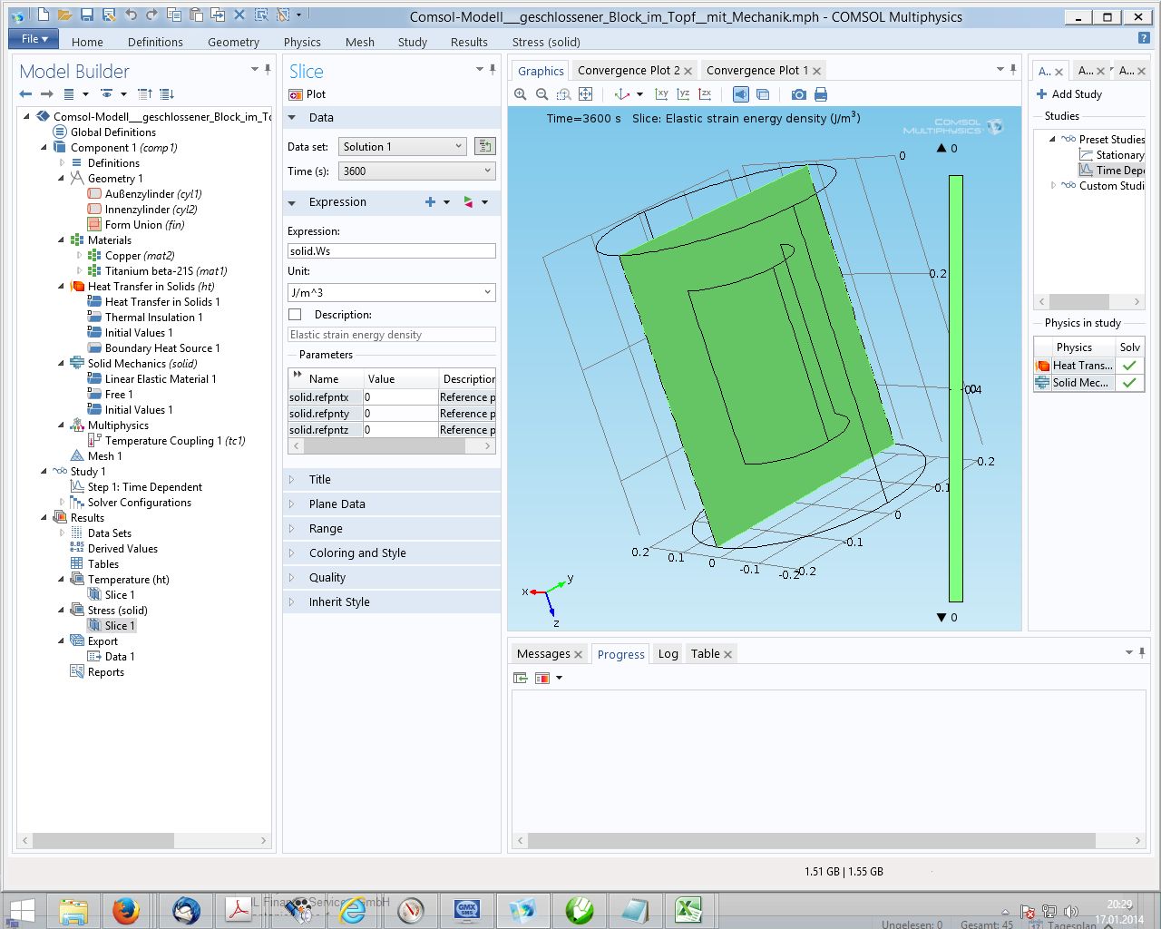

But I'm surpised, that the elastic strain energy density (solid.Ws (J/m^3)) and all other parameters like (solid.ep1) of the solid mechanics are exactly zero, without any decimals. As there is a temperature difference of 5K and the thermal expansion coefficients of the material differ by 10 exp(-5) I would expect some stress.
My impression is, there is no mechanics calculated.

In addition to the Temperature Coupling node under Multiphysics, you need a Thermal Expansion node.

Actually, what you did is nothing wrong per se (with or without the Structural Mechanics module); you fed the temperatures to the Solid Mechanics interface, so that any temperature dependent data (like material properties) would receive this temperature. There is no way the software could foresee whether you actually wanted only this or if you also wanted a thermal expansion to occur.
