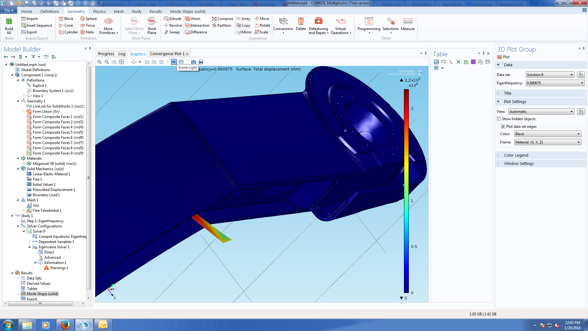

I am trying to run a vibration analysis on a part. I used the Solid mechanics module and the Eigenfrequency study. I specified the boundary condition, the loading and the material. But when i compute the study, two things occur. Firstly, some of the computed eigenfrequencies are imaginary, like 3.78i.What does that mean? Secondly the mode shape plot is completely confusing. I am attaching a screenshot for reference, as the model is a bit too large( 26MB). How do i get it it to work?

I'm afraid so. Let me try to explain what's happening. The coloured contour should be on the surface of the part. But it is appearing completely disjoint from the part, floating around in thin air...
Have you ever faced anything like this? And if so how did you resolve it?
I'm afraid so. Let me try to explain what's happening. The coloured contour should be on the surface of the part. But it is appearing completely disjoint from the part, floating around in thin air... Have you ever faced anything like this? And if so how did you resolve it?
