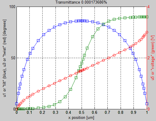

I have a Matlab code that solves four coupled differential equations, which works and gives me the attached plot. (The actual code is here: www.ee.ucl.ac.uk/~rjames/modelling/constant-order/oned/, scroll down to "lc3k.m" along with a description of the problem if you want more details.)
