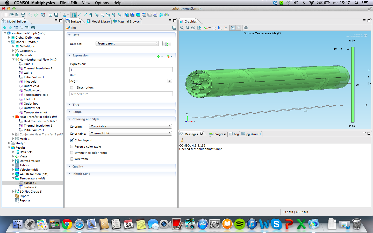

My model of a shell and tube heat exchanger has a constant temperature-profile.
It's possible that steady state inside the model is reached and overall temperature difference is made.
But this is not what I wanted of course.
How to solve this?

Maybe a picture will be better, if dropbox wouldn't work...
Fluid is flowing through 3 tubes and over it. There should be heat transfer though the fluid and solid tubewalls.
Everything stays at constant beginning temperature.

Dear Adriaan,
You are solving two heat transfer interfaces, nitf and ht. The first computes the temperature "T", the second "T2". These have no influence on eachother when they are not manually coupled.
The easiest solution is to remove the heat transfer in solids interface, and add a "heat transfer in solids" node in the non-isothermal flow interface. This makes sure that all is computed in one interface.
I would propose to take a look at the "shell-and-tube heat exchanger" in the model library.
Frank

Hello Frank,
Thanks for tip! I tried it before, but I think my problem then was that I just updated the solution and didn't re-solve it. With the all-in-one module "conjugate" I already got better results.
