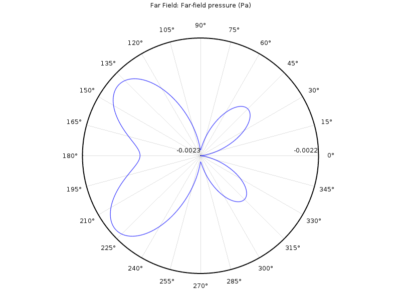

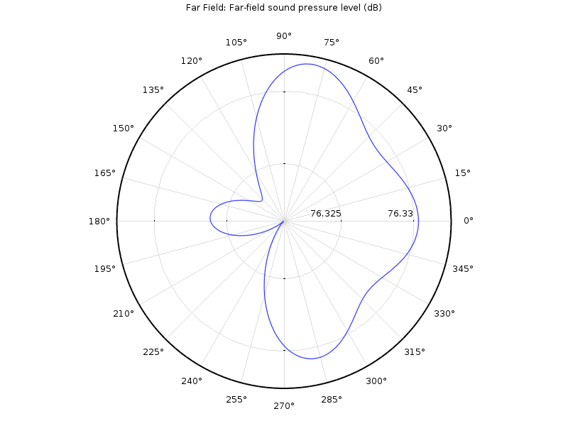

Here there are two figures corresponding to the tutorial model I referred, changing just the direction of the background pressure (now it travels in along x direction, (x,y,z= (1,0,0) ). I agree it depends on the mesh, probably, but with finer mesh I get similar (but not the same) results. they are similar in the sense that they are not symmetric, but the are not exactly the same results. Probably I am doing something wrong...

Well, take a look at those asymmetries.
They are tiny compared to everything else.
76.325 vs 76.33 dB
Zoom out a bit your polar plot and you should get your simmetric result.
Just try to refine the mesh, if the asymmetryes become smaller, those are only numerical problems (IMHO)
Stefano
Well, take a look at those asymmetries. They are tiny compared to everything else. 76.325 vs 76.33 dB Zoom out a bit your polar plot and you should get your simmetric result. Just try to refine the mesh, if the asymmetryes become smaller, those are only numerical problems (IMHO) Stefano
