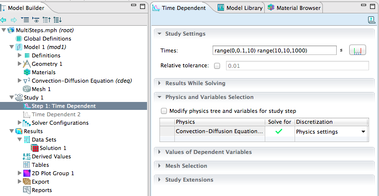

Thank you Marino, that's what I am trying to do. I am attaching a simple examle here in which I used two steps in study 1. It's a very simple diffusion-convection problem. You can see that in Data sets - Solution 1, only the time steps in the second study step are shown. How should I change the setup so the result from step 1 can also be stored?
Thanks!

Hi Huang,
I think that the problem is that you insert 2 different time steps.
Try to use only one (STEP 1) with the range set as in the picture and disabling STEP 2.
It should works now.

Hi, Marino,
You are right, it's easier to set it in your way.
If two different time steps are used in my original setup, in Solver configuration an extra Store Solution node should be added.

Hi Matej,
If you set your time step in Study Settings as suggested by Marino, all the results of different steps will be in one solution. If you have to use two study steps, then you must add a "Store Solution #" step in your solver. In Results-Data Sets menu, you can right click and select Join to combine them together.
Also, now I realize it's not a good practice to control time step at the study step setting, because here it specifies the solutions to be stored. If you choose very small steps, the final file probably will be too large. Now I only specify those steps I want to store, and control time step size through Time Stepping in Solver settings.
Hi Matej, If you set your time step in Study Settings as suggested by Marino, all the results of different steps will be in one solution. If you have to use two study steps, then you must add a "Store Solution #" step in your solver. In Results-Data Sets menu, you can right click and select Join to combine them together. Also, now I realize it's not a good practice to control time step at the study step setting, because here it specifies the solutions to be stored. If you choose very small steps, the final file probably will be too large. Now I only specify those steps I want to store, and control time step size through Time Stepping in Solver settings.
