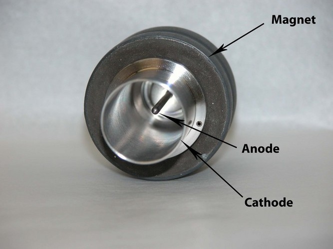

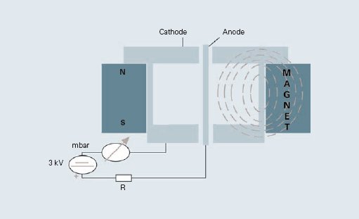

I try to get Current-Voltage Characteristic of Inverted Magnetron Vacuum Gauge using COMSOL.
(see image here ej.iop.org/images/0963-0252/21/3/035006/Full/psst402568f02_online.jpg )
I successfully modeled a coaxial DC glow discharge, but don't understand, how add axial magnetic field.

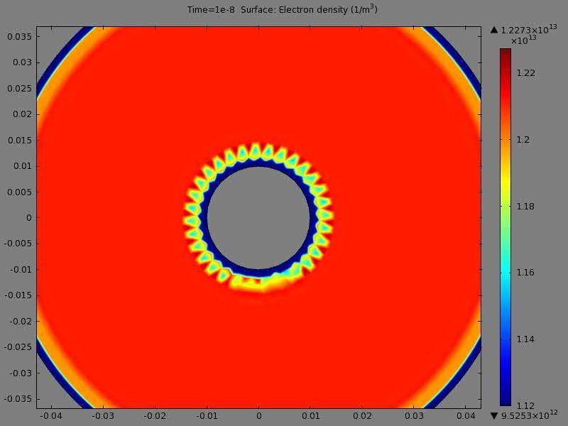

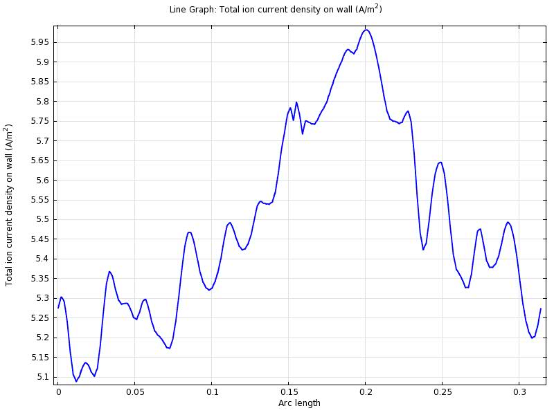

Of course I don't interest in sputtering process, I just want to get some information about plasma in crossed Electric and Magnetic fields ( coaxial diode with axial magnetic field )
I get some Ion-Current information for coaxial diode discharge without magnetic field (attach images).
