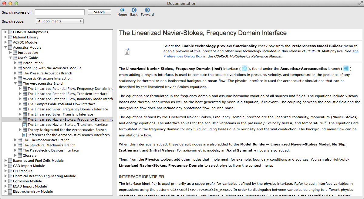

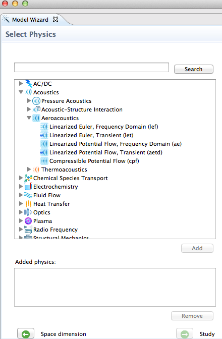

I reinstall the COMSOL 4.4 (with update 1), and can not find the linearised NS module in the aeroacoustics any more. I can also find the user guide of this module in the help file. (See attachment).
I built some model based on the linearised NS module with 4.4 version (no update 1).
It is too weird. How can I find the missing module?

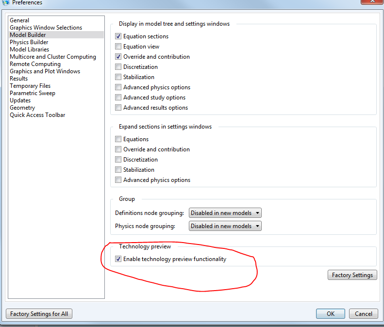

Have you enabled 'Technology preview'?
Henrik
Hi, Have you enabled 'Technology preview'? Regards, Henrik

Yes, it now appear in the aeroacoustic. could you please tell the function of the 'Technology Preview'? to display some new module developing but containing bugs?

Technology preview makes it possible to use some new and advanced technology that is still under development but is made available as a preview for users interested in that specific technology.
Henrik
Hi, Technology preview makes it possible to use some new and advanced technology that is still under development but is made available as a preview for users interested in that specific technology. Regards, Henrik
