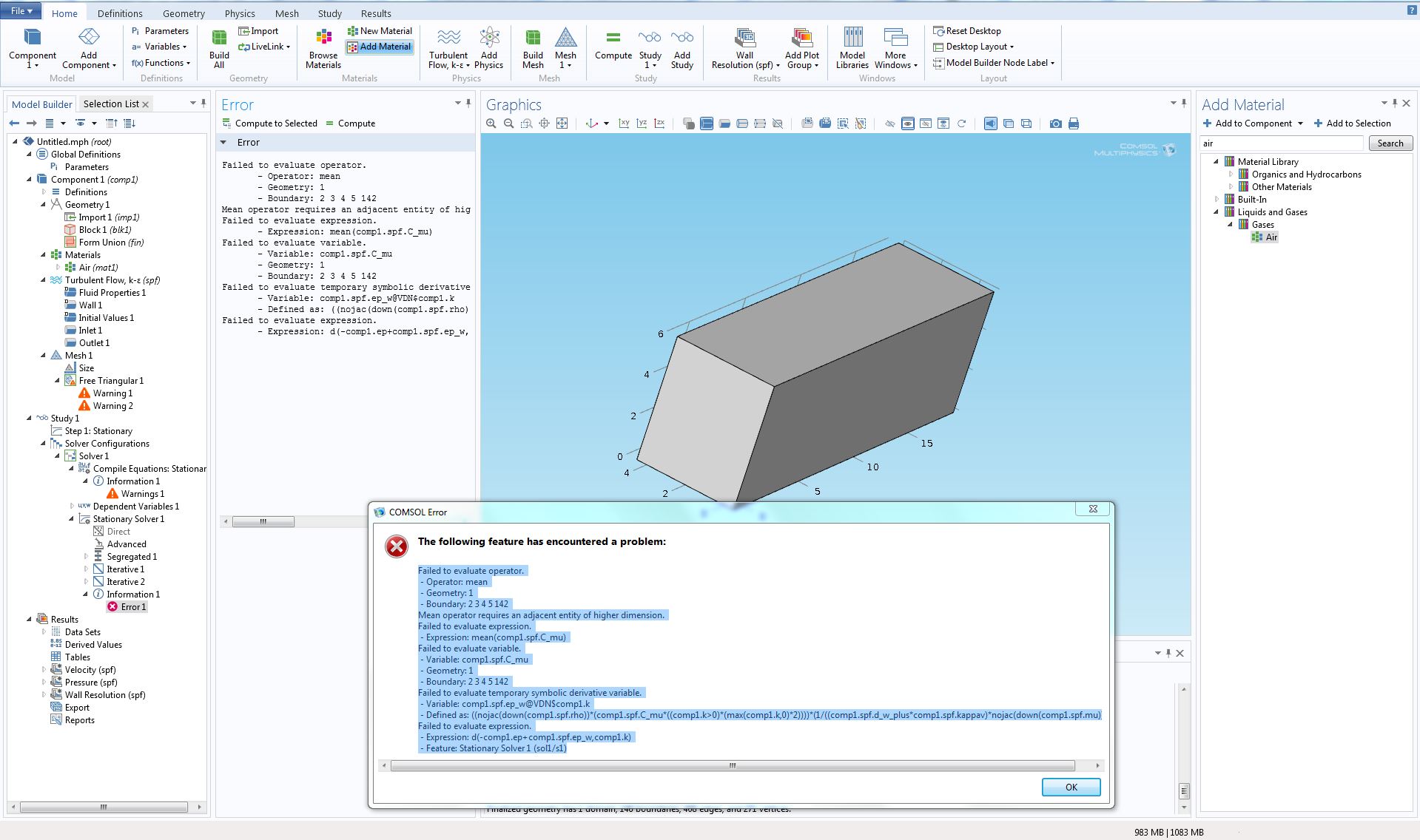

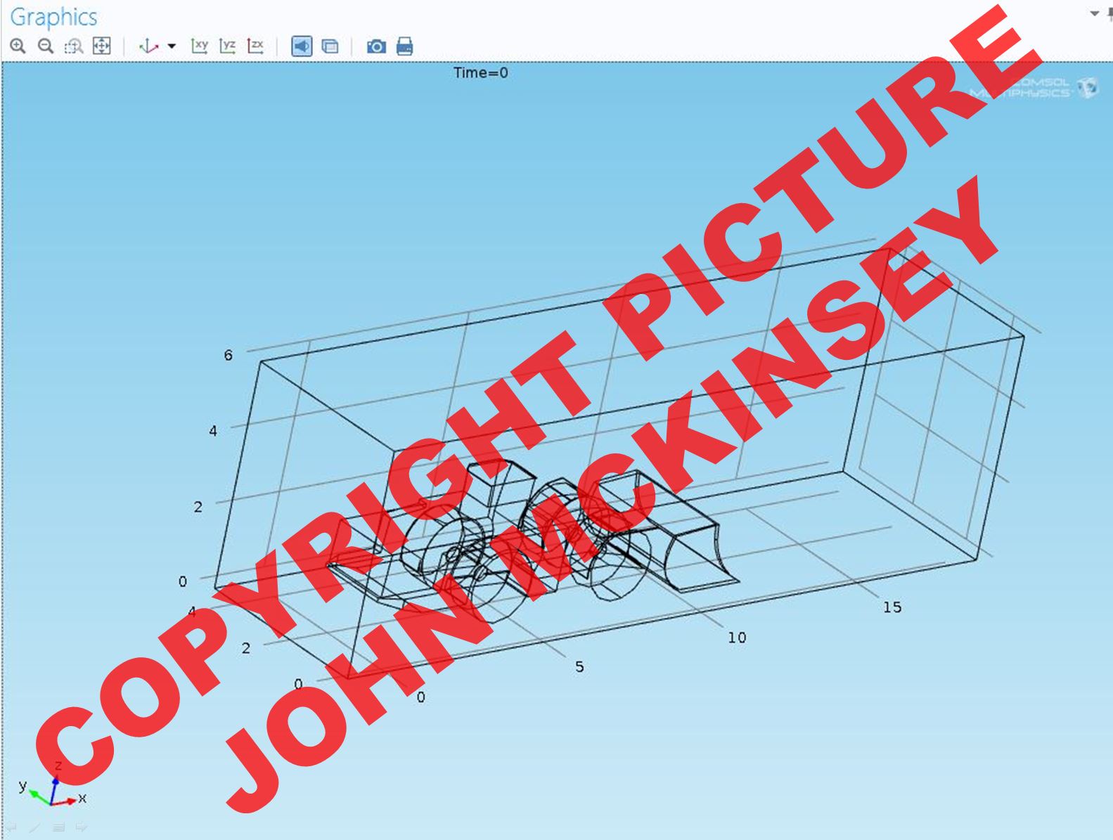

Now I'm trying to compute this model (can be seen attached, "model.jpg"), studying about air flow flowing through this equipment in a tunnel.
But, I don't know why, I got this message error after choosing the "compute" command (the error message is also attached, "comsol_error.jpg"):
Failed to evaluate operator.
- Operator: mean
- Geometry: 1
- Boundary: 2 3 4 5 142
Mean operator requires an adjacent entity of higher dimension.
- Expression: mean(comp1.spf.C_mu)
Failed to evaluate variable.
- Variable: comp1.spf.C_mu
- Geometry: 1
- Expression: nojac(max(11.06,((((0.5*(comp1.spf.C_mu^0.25))*sqrt(max(comp1.k,0)))*down(comp1.spf.rho))/(down(comp1.spf.mu)*(down(tremetric)^0.5)))))
- Variable: comp1.spf.d_w_plus
- Defined as: nojac(max(11.06,((((0.5*(comp1.spf.C_mu^0.25))*sqrt(max(comp1.k,0)))*down(comp1.spf.rho))/(down(comp1.spf.mu)*(down(tremetric)^0.5)))))
Failed to evaluate temporary symbolic derivative variable.
- Variable: comp1.spf.ep_w@VDN$comp1.k
- Defined as: ((1/((comp1.spf.d_w_plus*comp1.spf.kappav)*nojac(down(comp1.spf.mu))))*(nojac(down(comp1.spf.rho))*(comp1.spf.C_mu*((2*max(comp1.k,0))*(comp1.k>0)))))
- Expression: d(-comp1.ep+comp1.spf.ep_w,comp1.k)

I drew the geometry by myself in AutoCAD 2010, and exported it as an *.stl file format, and them used COMSOL to import that file. Is this the proper way to import files from AutoCAD?
Sure it is possible, here's the model attached.
So, maybe I have to redesign the model again? Is it that COMSOL cannot create mesh for complicated models? (Or it could create mesh but with high possibility of having errors, warnings, etc.?) Thanks for replying my post Mikael.
