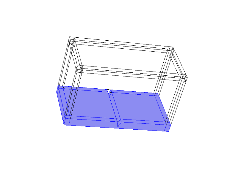

I have been trying to simulate the radiation pattern of a small dipole inside a groove carved into a gold substrate (transversal shape is triangular). The simulation box is rectangular, and I set 4 out of the 6 sides to Perfectly Matched Layer (the other two are the basis of the metallic region, which I set to PEC, and the face containing the dipole, where I have PMC in order to set a symmetry plane). The sides where I have PML end in a scattering boundary condition plane.
Although my box is reasonably large, I just don't manage to get rid of the reflections appearing in the electric field (in all directions!! but specially along the axis of the waveguide). I have tried varying PML thickness, PML mesh type, size and distribution, as well as PML scaling factor. I changed from version 4.2a into 4.3 to try the same as well. None of these tries reduced the reflections. Moreover, the field actually seems to be absorbed in the PMLs!! This suggests it may not be a PML problem but a size issue. However, by increasing the dimensions of my simulation box the result don't change either! I know for sure that people is able to solve this problem with smaller boxes than mine in V3.5 so I am quite perplex and don't know where the error might be. Has anyone of you had the same problem? Any clue of what may be going wrong?
