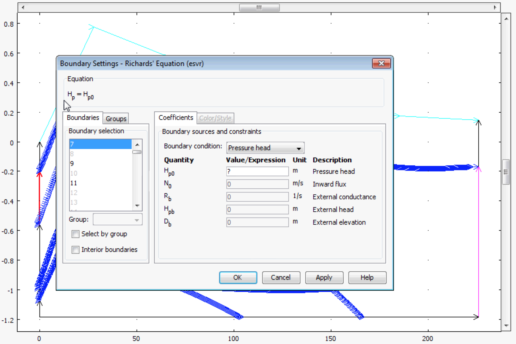

Hi all,
I want to define two conditions for one part of rectangular that I have in 2D (xz) and put two different value of pressure head in one boundary condition,
like Hp=0 if z>= - 0.5159m
and Hp=0.05159 if z< - 0.5159m
how is it possible to write these in one boundary condition?
Attached screen shot for better explanation

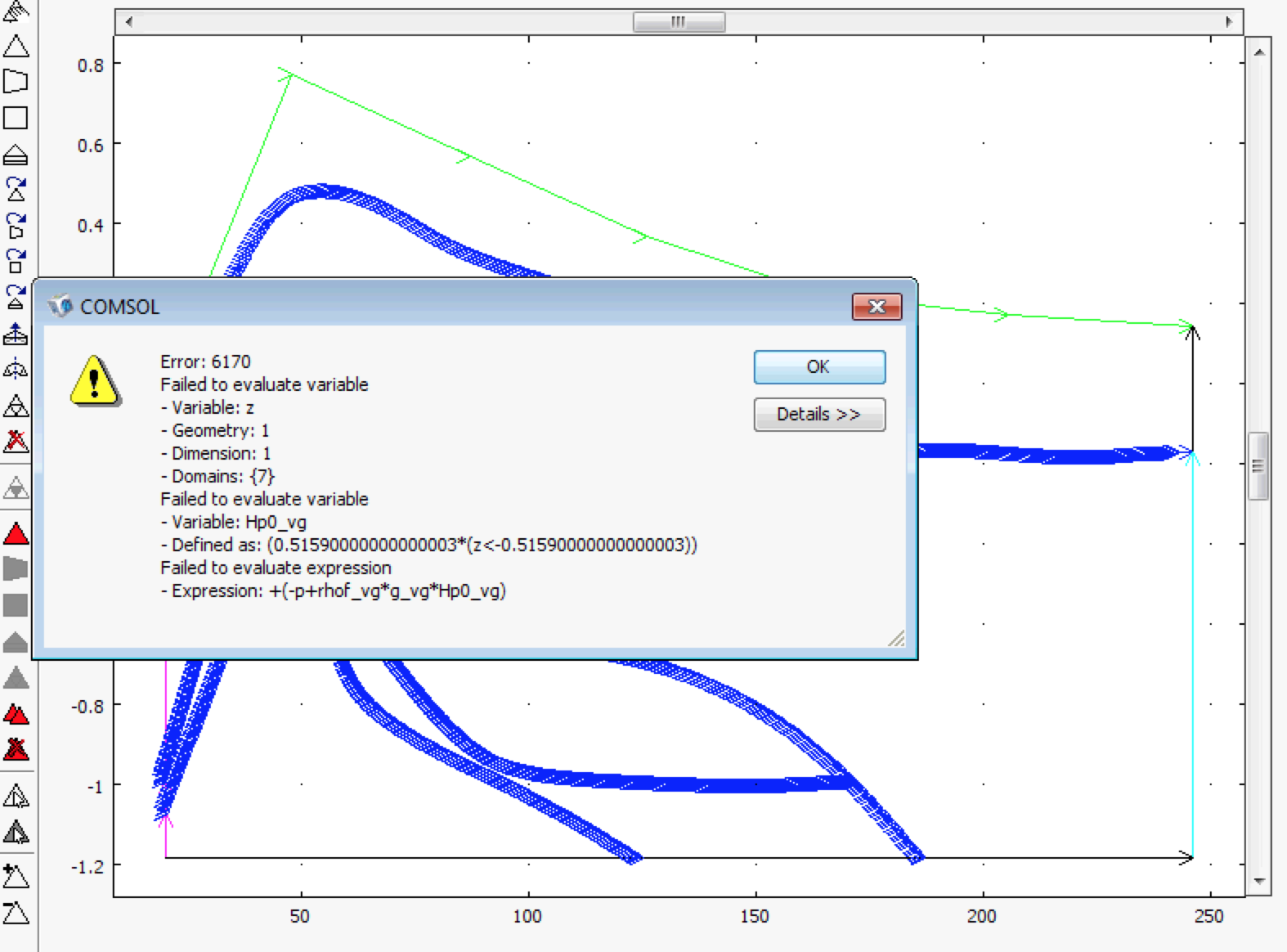

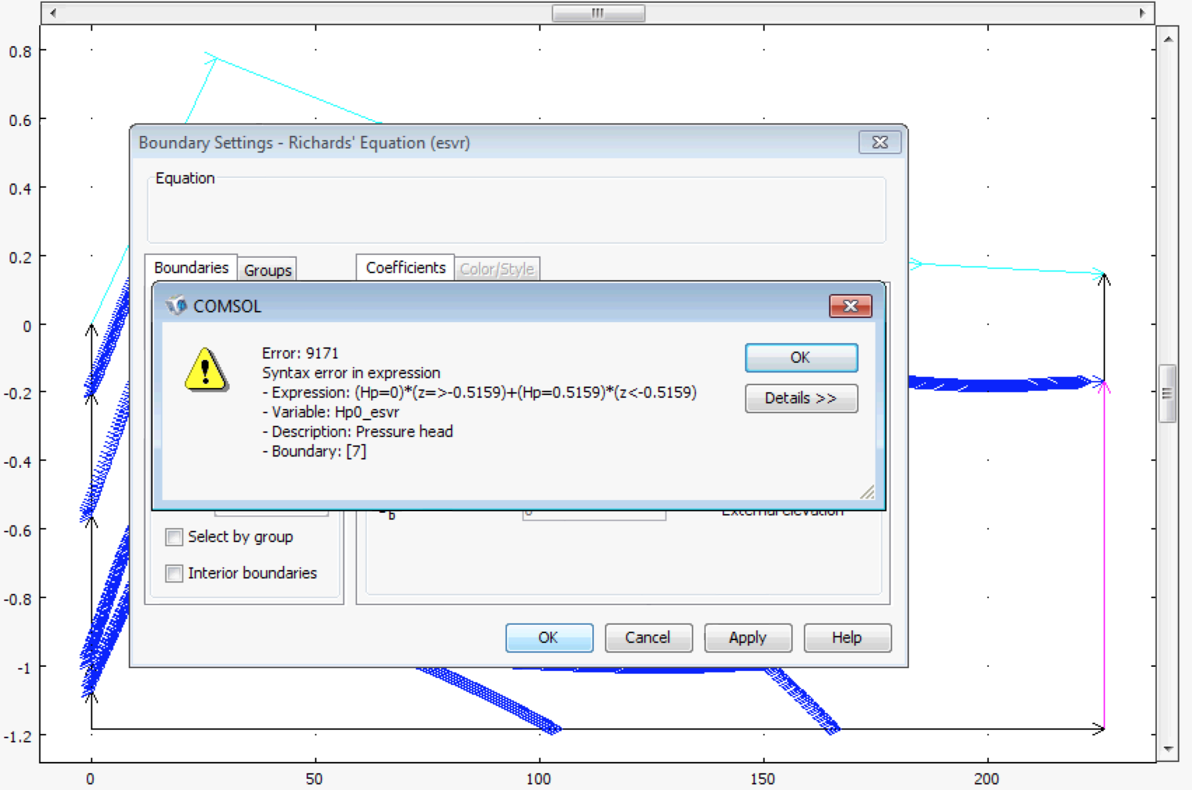

I wrote expression in a way that I put the screenshot, But I confronted with this error,
I am new in comsol and I need your help.
Best
Sepideh
I wrote expression in a way that I put the screenshot, But I confronted with this error, I am new in comsol and I need your help. Best Sepideh
Magnus Ringh COMSOL Employee
Posted: 1 decade ago 2014/03/19 4:53 GMT-4
Use the following expression:
0*(z>=- 0.5159)+0.05159*(z<- 0.5159)
or simpler just
Magnus Ringh, COMSOL

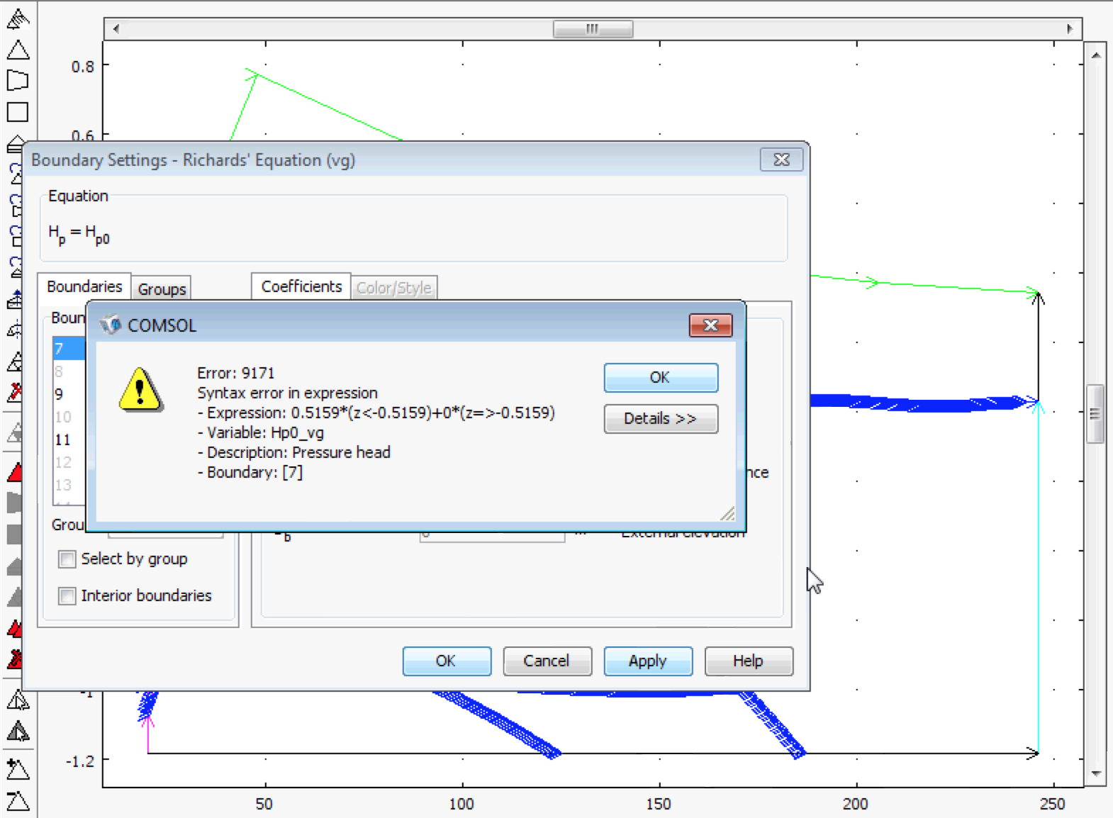

Thanks for reply Magnus,
I tried with the first expression and I confronted with error in screen shot1, and then I tried with the second expression and I confronted with screen shot2.
I am new to comsol, therefore your comments will help me a lot.
Sepideh

Hi again,
Could it be that none of your spatial coordinates is called z? Typically, in a 2D model, the spatial coordinate names are x and y.
Hi again, Could it be that none of your spatial coordinates is called z? Typically, in a 2D model, the spatial coordinate names are x and y. Best regards, Magnus Ringh, COMSOL
Posted: 1 decade ago 2014/03/20 11:39 GMT-4
Thanks a lot it worked with "y", and I just defined one side of rectangle for two types of condition like this
(C1*(p<p1) + C2*(p>=p1)). C1 and C2 are conditions.
Hope it helps for others.
Sepideh
Thanks a lot it worked with "y", and I just defined one side of rectangle for two types of condition like this (C1*(p=p1)). C1 and C2 are conditions. Hope it helps for others. Sepideh
